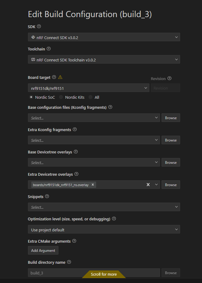

Hello everybody,
                         I am trying to get the RTC0 peripheral working on Nordic nrf9151-DK. I wanna use zephyr/driver_rtc.h library and zephyr/device.h librrary. I am able to use DEVICE_DT_GET with rtc0, but if I use another function working with device, like device_is_ready(), it makes error. The given device (rtc0) is not known to the compiler.
The main.c looks like this:

My prj.conf looks like this:
# Povolení konzole
CONFIG_CONSOLE=y
# Povolení standardního výstupu (např. printf)
CONFIG_PRINTK=y
CONFIG_RTC=y
CONFIG_CLOCK_CONTROL=y
CONFIG_CLOCK_CONTROL_NRF=y
CONFIG_NRFX_CLOCK=y
#CONFIG_NRFX_RTC=y
CONFIG_NRFX_RTC0=y
#CONFIG_NRFX_RTC1=y
CONFIG_MAIN_STACK_SIZE=2048
CONFIG_RTC_ALARM=y
CONFIG_RTC_UPDATE=y
nrf9151_dk_nrf9151_defconfig looks like this:

nrf9151dk_nrf9151_ns.overlay looks like this:
 * Copyright (c) 2024 Nordic Semiconductor ASA
&rtc0
	status="okay";
&clock {
    status = "okay";
&systick {
	zephyr,deferred-init;
nrf9151dk_9151_ns.dts looks like this:
 * Copyright (c) 2023 Nordic Semiconductor ASA
/dts-v1/;
#include <nordic/nrf9151_laca.dtsi>
#include "nrf9151dk_nrf9151_common.dtsi"
	chosen {
		zephyr,sram = &sram0_s;
		zephyr,flash = &flash0;
		zephyr,code-partition = &slot0_partition;
		zephyr,sram-secure-partition = &sram0_s;
		zephyr,sram-non-secure-partition = &sram0_ns;
&rtc0
	status="okay";
&clock {
    status = "okay";
&systick {
Build configuration looks like this:
Kind regards
Jaroslav Havel
