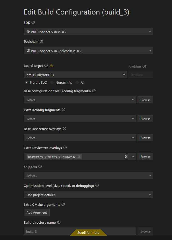

Hello everybody,
                        I am trying to get the RTC0 peripheral working on Nordic nrf9151-DK using libraries from Nordic (nrfx_rtc.h, nrfx_clock.h and hal/nrf_rtc.h). I am not able to run rtc_handler using IRQ. Could you please help me with getting RTC0 up and running?
Main.c looks like this:

My build configuration:
Could I use IRQ_CONNECT and irg_enable?
Kind regards
Jaroslav Havel

  • Hi Jaroslav,
    Jaroslav Havel said:
    But i think, I don't have to use IRQ_CONNECT, because I am using nrfx_rtc_tick_enable() funkction. Compilator said, that I am doing the same thing if I am using IRQ_CONNECT and nrfx_rtc_tick_enable().
    That sounds wrong. What did the compiler tell you?
    If I run code, I am not able to see anything inside while(1) loop. Could be some problem with internal fault that blocked all code?
    What is the full log?
    Hieu
