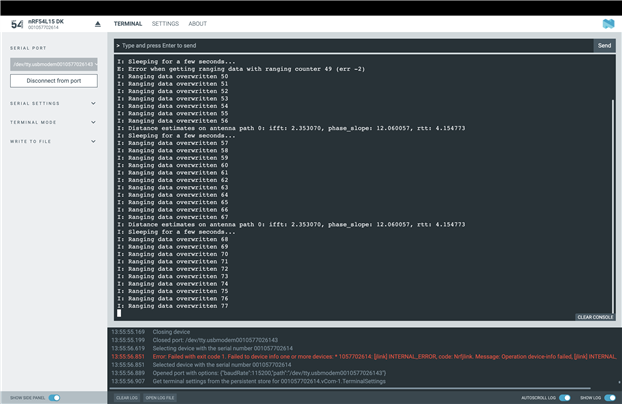

  • Hi Elfving,
    Thanks for your help. I was attempting to run the samples in my own workspace, which may have had a mismatched toolchain.
    Working in the
    /opt/nordic/ncs directory, everything is working (on mac).
    Ran into the following error when using our custom board at >1m distance - is this something which is common place with boards with poor signal strength?
