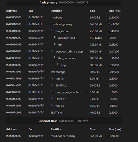

zephyr generation partitions.yml
EMPTY_0:
  address: 0xf000
  end_address: 0x10000
  placement:
    before:
    - mcuboot_pad
  region: flash_primary
EMPTY_1:
  address: 0xe0000
  end_address: 0x100000
  placement:
    after:
    - mcuboot_secondary
EMPTY_2:
  address: 0xc2000
  end_address: 0xc8000
  placement:
    after:
    - tfm_its
app:
  address: 0x68000
  end_address: 0xc0000
external_flash:
  address: 0x0
  end_address: 0x800000
  region: external_flash
mcuboot:
  address: 0x0
  end_address: 0xf000
  placement:
    before:
    - mcuboot_primary
mcuboot_pad:
  address: 0x10000
  end_address: 0x10200
  placement:
    align:
      start: 0x8000
    before:
    - mcuboot_primary_app
mcuboot_primary:
  address: 0x10000
  end_address: 0xd8000
  orig_span: &id001
  - tfm
  - mcuboot_pad
  - app
  sharers: 0x1
  span: *id001
mcuboot_primary_app:
  address: 0x10200
  orig_span: &id002
  - app
  - tfm
  span: *id002
mcuboot_secondary:
  address: 0xd8000
  end_address: 0xe0000
  placement:
    after:
    - mcuboot_primary
    align:
      start: 0x8000
    align_next: 0x8000
  share_size:
  - mcuboot_primary
mcuboot_sram:
  address: 0x20000000
  end_address: 0x20016000
  orig_span: &id003
  - tfm_sram
  region: sram_primary
  span: *id003
nrf_modem_lib_ctrl:
  address: 0x20016000
  end_address: 0x200164e8
  inside:
  - sram_nonsecure
  placement:
    after:
    - tfm_sram
    - start
nrf_modem_lib_rx:
  address: 0x20018568
  end_address: 0x2001a568
  inside:
  - sram_nonsecure
  placement:
    after:
    - nrf_modem_lib_tx
nrf_modem_lib_sram:
  address: 0x20016000
  orig_span: &id004
  - nrf_modem_lib_ctrl
  - nrf_modem_lib_tx
  - nrf_modem_lib_rx
  span: *id004
nrf_modem_lib_tx:
  address: 0x200164e8
  end_address: 0x20018568
  inside:
  - sram_nonsecure
  placement:
    after:
otp:
  address: 0xff8108
  end_address: 0xff83fc
  region: otp
sram_nonsecure:
  address: 0x20016000
  end_address: 0x20040000
  orig_span: &id005
  - sram_primary
  - nrf_modem_lib_tx
  - nrf_modem_lib_rx
  span: *id005
sram_primary:
  address: 0x2001a568
sram_secure:
  address: 0x20000000
  orig_span: &id006
  - tfm_sram
  span: *id006
tfm:
  address: 0x10200
  end_address: 0x68000
  inside:
  placement:
    before:
    - app
tfm_its:
  address: 0xc0000
  end_address: 0xc2000
  inside:
  - tfm_storage
  placement:
    align:
      start: 0x8000
    before:
    - tfm_otp_nv_counters
tfm_nonsecure:
  address: 0x68000
  orig_span: &id007
  - app
  span: *id007
tfm_otp_nv_counters:
  address: 0xc8000
  end_address: 0xca000
  inside:
  - tfm_storage
  placement:
    align:
      start: 0x8000
    before:
    - tfm_ps
tfm_ps:
  address: 0xd0000
  end_address: 0xd4000
  inside:
  - tfm_storage
  placement:
    align:
      start: 0x8000
    before:
    - end
tfm_secure:
  address: 0x10000
  orig_span: &id008
  - mcuboot_pad
  - tfm
  span: *id008
tfm_sram:
  address: 0x20000000
  inside:
  - sram_secure
  placement:
    after:
    - start
tfm_storage:
  address: 0xc0000
  orig_span: &id009
  - tfm_ps
  - tfm_its
  span: *id009

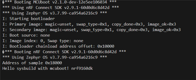

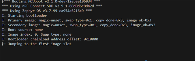

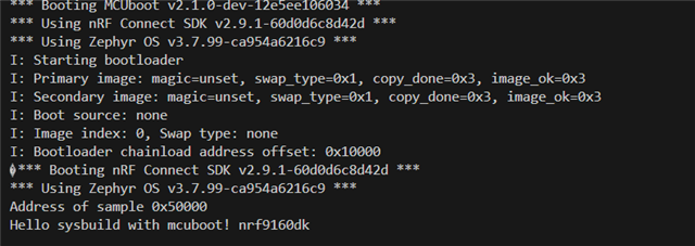

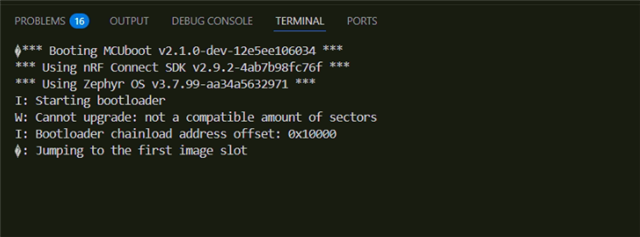

The output
And the funny thing is sometimes it boots into application but after hours of waiting here. As I left it like this yesterday and the application was booted and I again restarted the mcu the application got stuck here

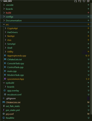

Here is my project folder setup
and here are my project based .conf files which have encryption and other stuff activated

I will get back to external flash mcuboot issue later but first I want to boot into my normal application as a normal bootloader
    The size of the secondary mcuboot partition has me a bit interested.
    The size is 0x8000 in both your defined pm_static and the generated partitioning map, whereas it should be the same size as your primary mcuboot application slot.
    I think that maybe this course on our academy pages with theory for DFU in NCS could be helpful https://academy.nordicsemi.com/courses/nrf-connect-sdk-intermediate/lessons/lesson-9-bootloaders-and-dfu-fota/
    There's lessons (with solutions) for your use case, i.e OTA with external flash and a lesson for LTE OTA (if that's the end goal) as well as BLE OTA.
    Let me know if you've reviewed this topic on the pages already or not

  • yes I gave that size because right now I dont want to load any application to secondary slot.
    I only want my system to load into my application thats all, basically I just want right now the mcuboot to jump to my main application and I think it should as it wont get any header on secondary slot and it should jump to primary.
    Thats the reason I kept secondary slot that low memory footprint.
    As you can see the mcuboot says it jumps and I also mentioned that I left it like this yesterday when I came back to it in the morning surprisingly my application was working

    Although I tested external flash as well and I was getting an issue that mcuboot was not able to read and write to the flash I isolated that issue but will get back to it later after I solve this issue of simply booting into my application
  • Great, keep me posted.
    To be honest I expect it to be unrelated to the external flash, but since the docs mention the same output that you showcased I think it's worth to isolate if this is the reason or not before we start speculating out of thin air!
    Andreas
  • okay so after going through some resources and also following nrf connect intermediate guide I was able to use external flash as an secondary storage
    This auto generated parition.yml file
    As you can see now in output, all the warning are not even showing and mcuboot is showing correct outputs now but still when its jump to first image slot it get stuck and my application is never booted

  • Also I tried external flash with hello_world program and my system immediately booted into application
    Also I added my above crypto.conf to project and hello_world application still booted
    Also I kept same partitions for both projects hello_world and my main application
