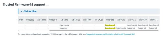

commission error after enable matter T-FM
Hi everyone,
I'm developing a Matter device on the nRF54L15 platform using NCS 2.9.0. When commissioning the device via HomePod and iPhone, the device unexpectedly reboots during the commissioning process.
Issue Description:
When I enable T-FM (build with */_ns), the device hits a Secure Fault and resets during communication handling ReadRequest messages. However, if I disable the T-FM, the commissioning process completes normally without reboots.

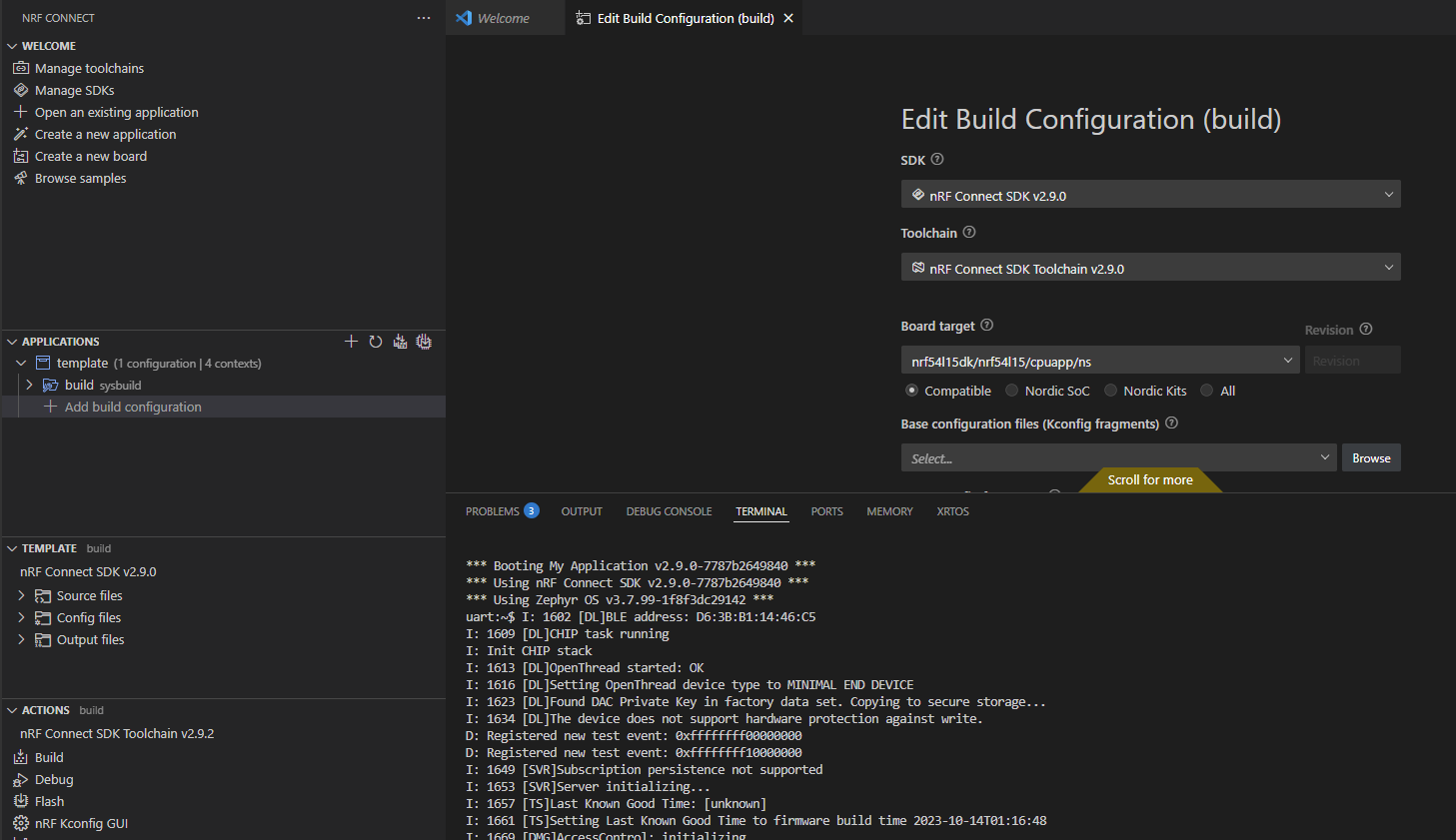

  • I tried template demo with NRF54L15DK, occurred the  same problem.
    I cannot reproduce the issue with v2.9.0/samples/matter/template building for nrf54l15dk_nrf54l15_cpuapp_ns.
    Please update the SDK and try again.
    -Amanda H.
  • Hi, Amanda,
    thank you for your reply. Did you mean that this firmware can be commissioned normally? Could you send it to me for a test? I'd like to confirm with you that the error occurred during the commissioning process, not the project-building process.
  • Could you test v2.9.0/samples/matter/template building for nrf54l15dk_nrf54l15_cpuapp_ns? Do you see any issues?
