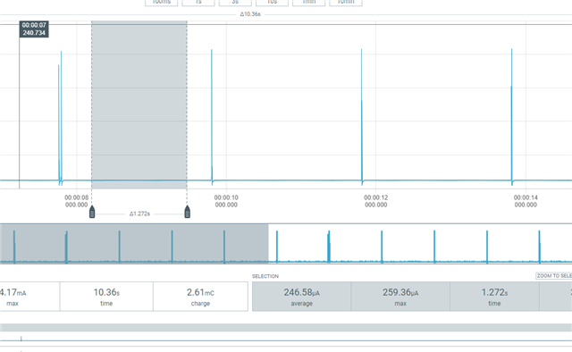

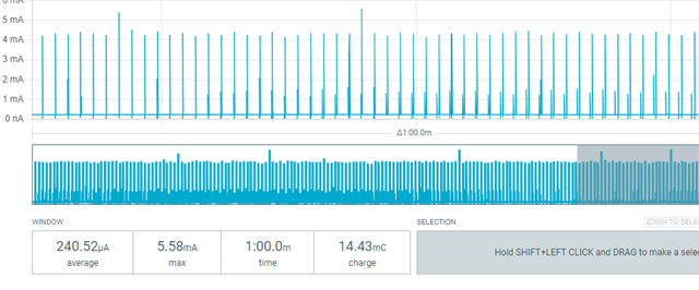

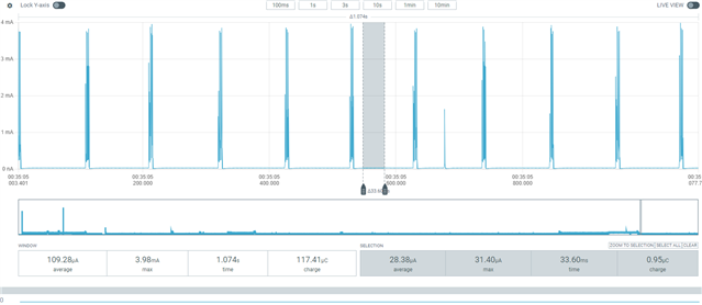

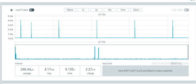

I am getting a issue with BLE power consumption, when I turned BLE on, the current is about 9uA. with BLE beacon On then the current is about 240uA

    I attached here a LBS sample that you can try to test on your board (you can build for DK and flash on  your board , it should still run) . The sleep current should be around 29uA when doing BLE.
    peripheral_lbs_nrf53.zip
    Please try to test on your board to see if you have similar number.

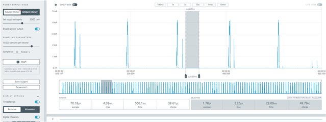

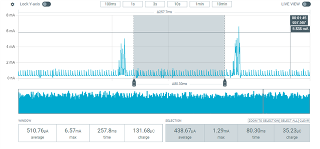

    I built peripheral_lbs_nrf53.zip with nrf5340dk_nrf5340_cpuapp_ns and flash to nRF5340DK, the current is about 500uA

  • Hi Hung,
    the result above is using nRF5340DK and your code.
    because when I turned BLE off then the current dropped to 9uA, so I am asking BLE configuration affected to power.
    Could you have any recommendation about BLE configuration?
    nRF5340 uses dual core, so I think the configuration can make power change

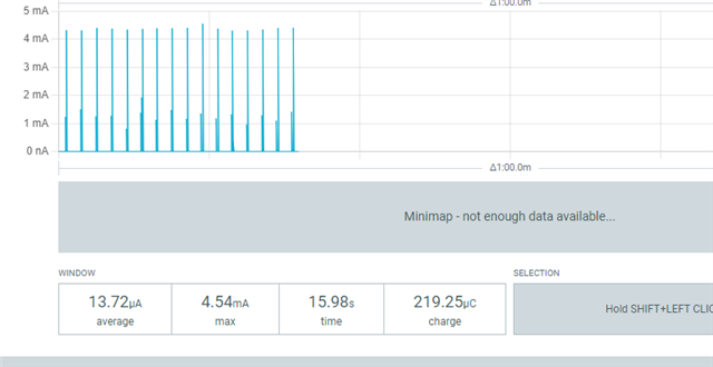

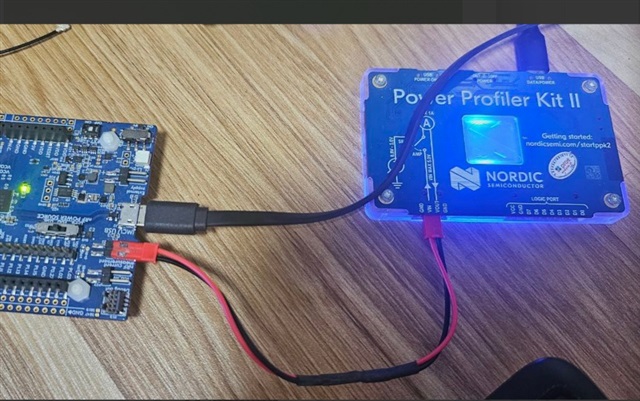

    I think we can focus on the nRF53 DK and align the measurement to make sure we are seeing the same number.
    Please let us know your nRF53DK version number. Maybe take a photo of your set up , how you connect the PPK2.
    Second, please use the attached hex file , and select the source mode from the Power Profiler application. Make sure you do 3.0 V, not 3.3 as 3.3 will create leakage on the board.
    At 3.0V you should see the sleep current only 1-2 uA.

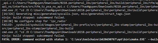

    I noticed that you were using child-parent image in the original question, but the nrf5340-ble-power.rar you sent us has sysbuild folder, could you explain ?
