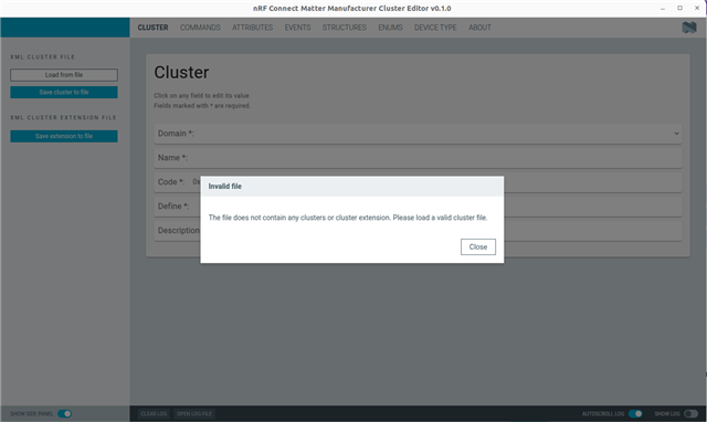

    I have gone through the section on creating a cluster extension. I have taken OccupancySensing.xml from the path /home/bhavya/ncs/v3.0.1/modules/lib/matter/data_model/1.4.1/clusters/OccupancySensing.xml but the tool shows below error:
    Can you please check if I am doing any wrong steps? Basically, I want to modify Occupancy cluster.
    Bhavya
  • Hi Bhavya,
    You need to use the Occupancy server cluster from ncs/v3.0.1/modules/lib/matter/src/app/zap-templates/zcl/data-model/chip/ as a source file, that is, this file: https://github.com/nrfconnect/sdk-connectedhomeip/blob/v3.0.1/src/app/zap-templates/zcl/data-model/chip/occupancy-sensing-cluster.xml
