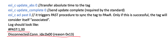

> esl_c acl past 0
esl_c acl past 0
#PAST:0,00,-134

So why it is different between my result and Nordic Bluetooth ESL Tutorial?
