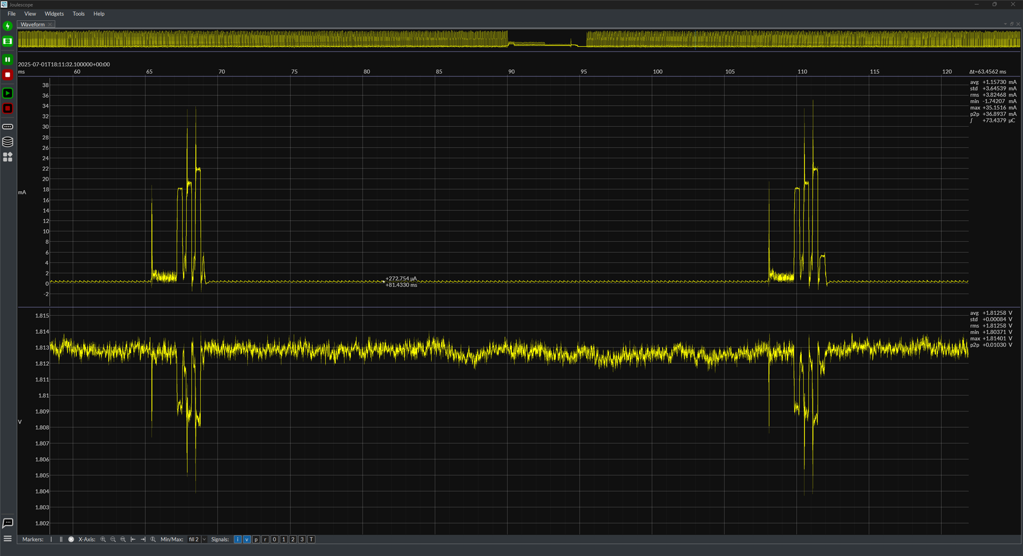

Hi, on nRF54L15 Dev Kit, we are trying to validate our sleep current consumption. We are seeing sleep current of ~100-300uA, when it should be a fraction of that. As per datasheet section 11.1.2.1 SleepSYSTEM ON with full 256KB RAM retention should draw ~3uA.
We have enabled CONFIG_PM_DEVICE=y which should disable all peripherals. My thought was that maybe the FLPR is not configured to sleep? Any ideas?

In our power usage, we see the radio activity once every ~40-50ms (roughly), which is normal. But in between, we see 100-300uA at idle.
We are using the internal RC as the low-frequency clock.
