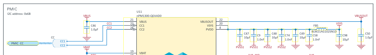

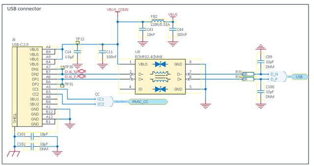

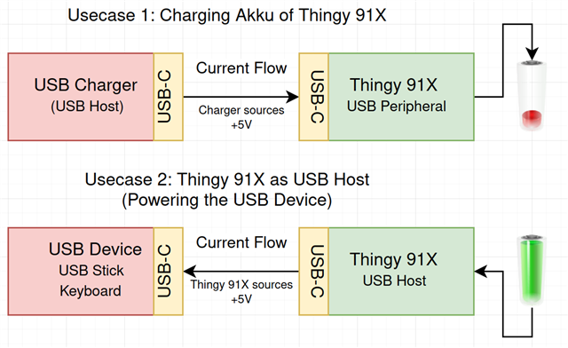

  • Hi Hieu,
    thank you very much for your feedback. I took a look at the hardware files at the thingy 91X but seem to be too stupid to understand how the thingy can provide power to an external connected USB-C device.
    So I have illustrated the two use cases one more time below in case my explanation was bad.
    I fully understand `Usecase 1`, the nPM1300 does the USB-C addressing via the CC lines and sinks the power from the charger through the VBAT pin.
    But how `Usecase 2` work? What I am not getting is that in my opinion, either the nPM1300 or the nrf5340 have to source the VBAT pin of the USB connect J6.
    The only possibility I see is that the nPM1300 reverts the VBUSOUT and VBUS path, which is not possible based on the nPM1300 manua: https://docs-be.nordicsemi.com/bundle/ps_npm1300/page/nPM1300_PS_v1.2.pdf?_LANG=enus
    So, I think I am trying to achieve something which is simply not possible with the Thingy91X. Based on this ticket, the nrf5340 (to which the USB lines D+/D-) are connected, does not support USB host mode.  Can the nRF5340 act as a USB host?
    But if I would use a CPU which supports USB Host mode, does the nPM1300 would support Usecase 2?
