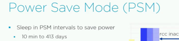

    I have successfully implemented regular PSM in my project. One thing I noticed though is that some Nordic documentation  states that the smallest PSM requested interval is 10 minutes:
    Source: https://www.youtube.com/watch?v=n2dLagfST44
    Timestamp: 8:13
    Question: Since my device sends data to the server every 3 minutes, will this be an issue or violate some cell network rules? Is there some rule that says PSM must be used for a minimum of 10 minutes consecutively?
    It is my understanding that the modem can wake up early before the TAU timer expires without any negative effect from the network or from a power consumption standpoint, correct?

  • Hi Derek,
    PSM interval can be requested but it is determined by the network. The interval specifies how long device can sleep before it needs to perform TAU. It is possible for device to wake up from PSM and start sending data at any point. Every time device wakes up and sends data, tracking area update timer is reset.

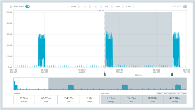

    For using RAI, I do not specify SO_RAI in my socket options when sending data, or anywhere for that matter. It seems to automatically trigger as soon as I close the socket, which is what I want.
    Testing with a Power Profiler Kit 2, I can see my configuration working as expected, including RAI.
    3-minute interval:

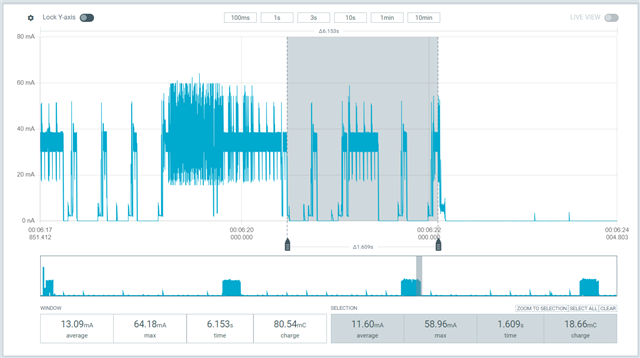

    Note: The small spikes are expected as they are the app core waking up to feed a watchdog every 5 seconds.
    PSM floor:
    RAI is triggered after socket close:

  • I managed to test PSM fallback by using a CAT-1 T-Mobile SIM. If you have a CAT-! T-Mobile SIM that uses the APN "fast.t-mobile.com", this APN does not support PSM as confirmed to me directly by T-Mobile.
    To enable proprietary PSM, I simply defined CONFIG_LTE_PROPRIETARY_PSM_REQ=y in my prj.conf. This will send the appropriate AT commands to enable this feature automatically on modem power up.
    Test results:
    CONFIG_LTE_PROPRIETARY_PSM_REQ=n
    The small current spikes between the large spikes are a 5 second watchdog feed. Other than that, between each 5 second spike, the PSM floor current is ~2.77 uA just like regular PSM granted by the network.
