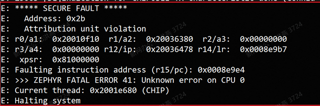

I: 149789 [EM]>>> [E:21632r S:39875 M:205759564] (S) Msg RX from 0:FFFFFFFB00000000 [0000] to 0000000000000000 --- Type 0001:02 (IM:ReadRequest) (B:51)
E: ***** SECURE FAULT *****
E:   Address: 0x2b
E:   Attribution unit violation
E: r0/a1:  0x20010dcc  r1/a2:  0x20036a00  r2/a3:  0x00000000
E: r3/a4:  0x00000000 r12/ip:  0x20036af8 r14/lr:  0x00094a9b
E:  xpsr:  0x81000000
E: Faulting instruction address (r15/pc): 0x00094ad4
E: >>> ZEPHYR FATAL ERROR 41: Unknown error on CPU 0
E: Current thread: 0x2001ed40 (CHIP)
E: Halting system

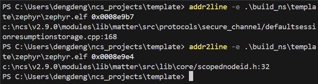

  • Did you use a DK for this denghongyan?
    Elfving

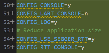

  • Yeah, for addr2line, I opened some log, if not, cannot use addr2lie:
    here is my prj_conf:

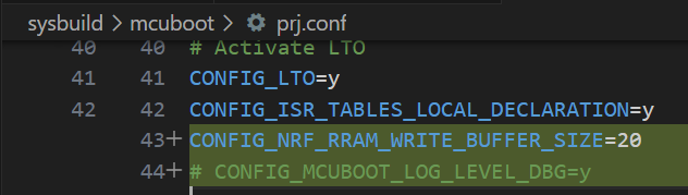

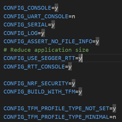

  • Hi EIfving,
    I build a pure verison, just prj.conf add rtt log:
    here is my commissiong log txt:
    E:   Address: 0x2b
    E: r0/a1:  0x20010ddc  r1/a2:  0x20034f80  r2/a3:  0x00000000
    E: r3/a4:  0x00000000 r12/ip:  0x20035078 r14/lr:  0x0008f8b7
    E:  xpsr:  0x81000000
    E: Faulting instruction address (r15/pc): 0x0008f8f0
    E: Current thread: 0x2001e510 (CHIP)
    E: Halting system
    here is the error address to line:
  • Hi,Elfving
    I checked with addr2line.
    Setting up addr2line on Windows takes some time, so I checked the elf address on Linux.
    The result is below.
    hosi2ng4@hosi2ng4-ThinkBook-14-G4-IAP:~/lock2/build/lock2/zephyr$ addr2line -e zephyr.elf 0x00094a9b
    /home/hosi2ng4/ncs/v2.9.2/zephyr/include/zephyr/net/net_if.h:1095
    hosi2ng4@hosi2ng4-ThinkBook-14-G4-IAP:~/lock2/build/lock2/zephyr$ addr2line -e zephyr.elf 0x00094ad4
    /home/hosi2ng4/lock2/build/lock2/modules/connectedhomeip/../../../../../ncs/v2.9.2/modules/lib/matter/src/inet/InetInterface.cpp:943
    This is occurring in the same file as denghongyan.
    I think the address is different because denghongyan is doing it in the template sample code.
    best regards,
    Hiroki
