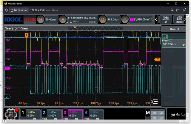

i am trying to read multiple mcp9600 on the nrf9151 on my thingy 91x. I connected 3 of the mcp9600 to my stemma QT connector and it all works fine.
However, when i connect a fourth mcp9600 to my i2c bus, the signal on my SDA line completely breaks. (see picture) Yellow is the SDA line at 3V3 behind the level shifter, and purple is SDA at 1V8 before the level shifter.
Interestingly, the same thing happens, when i add any kind of other device to the bus, or simply another 5k pullup resistor to the SDA line.

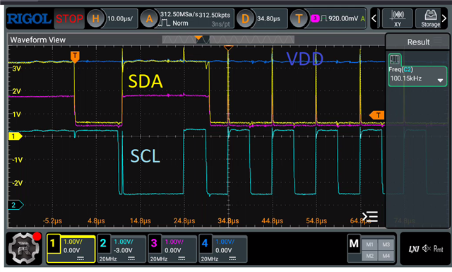

This is, how it looks like, when working.

So far i have tried a different thingy 91x, different MCP9600, different Connectors.
The whole setup works an a nRF5340 DK, but not on the thingy. The adresses of the i2c devices are also not the problem.
