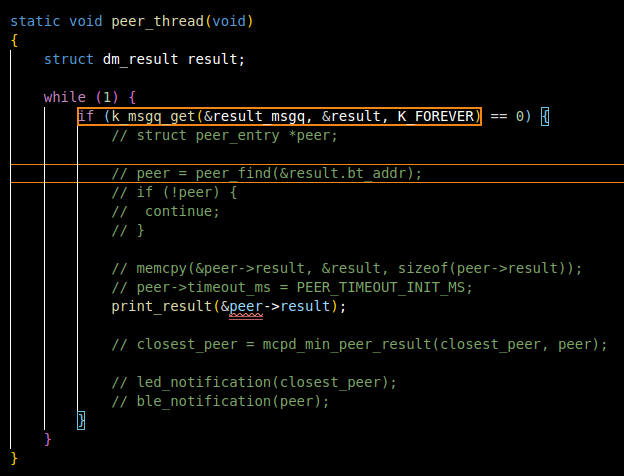

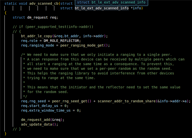

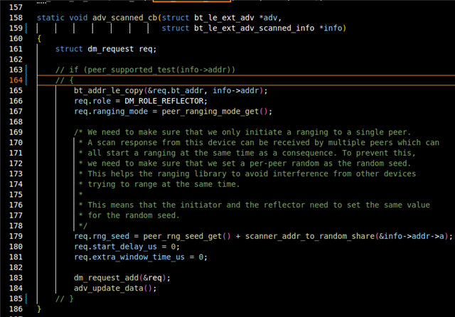

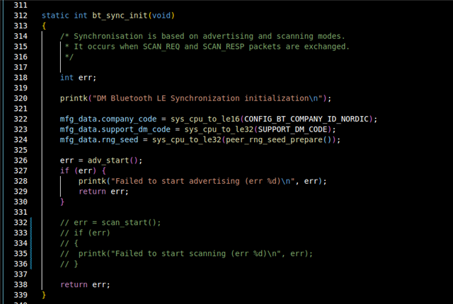

Here is what i have changed in the sample.
Changes to make it Advertiser only:
Changes to make it scanner only:
