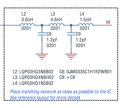

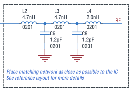

The PCN 219 rev 1.1 says "The new device revision of nRF54L15-CAAA is not drop-in compatible with the current revision, requiring update to PCB schematic
and layout".
It is clear what nRF54L15 rev 2 has to have rev 0.7 BOM
However, should rev 1 use older rev 0.6 BOM instead of rev 0.7?
