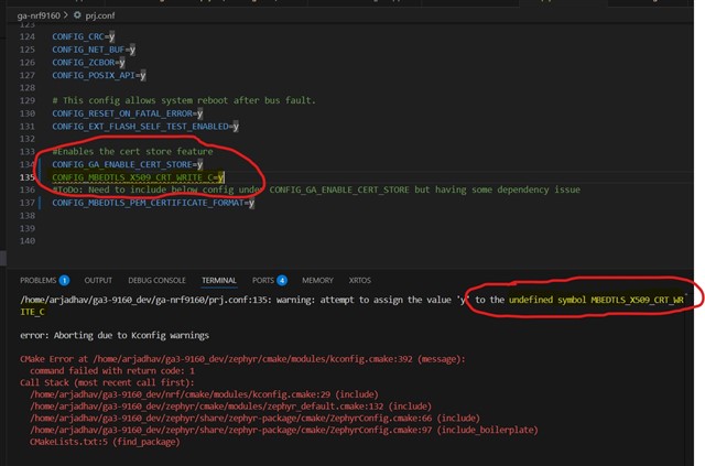

Failed to define MBEDTLS_X509_CRT_WRITE_C even after adding appropriate configs in prj.conf file
I am having nRF9160 with modem FW = 1.3.6 and nrf sdk version 2.7.0
I am using MBEDTLS library for generating self-signed & CSR certificates with EC-Key and RSA key. I am adding following configs in my prj.conf file
    MBEDTLS_X509_CSR_WRITE_C
    MBEDTLS_X509_CREATE_C
    MBEDTLS_ENTROPY_C
    MBEDTLS_CTR_DRBG_C
    MBEDTLS_PK_WRITE_C
    MBEDTLS_ZEPHYR_ENTROPY
    MBEDTLS
    MBEDTLS_ENABLE_HEAP
    MBEDTLS_TLS_LIBRARY
    MBEDTLS_X509_LIBRARY
    NRF_SECURITY_ADVANCED
    NORDIC_SECURITY_BACKEND
    MBEDTLS_DHM_C
    MBEDTLS_ECDH_C
    MBEDTLS_ECDSA_C
    MBEDTLS_ECP_C
    MBEDTLS_ECJPAKE_C
    MBEDTLS_GCM_C
    MBEDTLS_CIPHER_C
    MBEDTLS_RSA_C
    PSA_WANT_RSA_KEY_SIZE_2048
Even after enabling this configs MBEDTLS_X509_CRT_WRITE_C is not getting enabled in autoconf.h file. Because of this I am not able to compile the code and go ahead.
Can you please suggest probable reason or steps to get this resolved.
  • Attaching my compilation logs for your reference
    [268/399] Building CXX object CMakeFiles/app.dir/src/CertStoreMgnr/CertStoreMgnr.cpp.obj
    FAILED: CMakeFiles/app.dir/src/CertStoreMgnr/CertStoreMgnr.cpp.obj
    ccache zephyr-sdk-0.16.5-1/arm-zephyr-eabi/bin/arm-zephyr-eabi-g++ -DAPP_VERSION=v2.7.0 -DKERNEL -DK_HEAP_MEM_POOL_SIZE=16384 -DMBEDTLS_CONFIG_FILE=\"nrf-config.h\" -DMBEDTLS_PSA_CRYPTO_CONFIG -DMBEDTLS_PSA_CRYPTO_CONFIG_FILE=\"nrf-psa-crypto-want-config.h\" -DMBEDTLS_PSA_CRYPTO_USER_CONFIG_FILE=\"nrf-psa-crypto-config.h\" -DNRF9160_XXAA -DNRF_SKIP_FICR_NS_COPY_TO_RAM -DNRF_TRUSTZONE_NONSECURE -DTFM_PSA_API -DUSE_PARTITION_MANAGER=1 -DZCBOR_ASSERTS -D_ANSI_SOURCE -D__LINUX_ERRNO_EXTENSIONS__ -D__PROGRAM_START -D__ZEPHYR__=1 -I_dev//src/Sockets/. -I_dev//src/Common/ATJSON/. -I_dev//src/Common/BuildInfo/. -I_dev//src/Common/UART/. -I_dev//src/Common/Version/. -I_dev//src/Common/CertMgmt/. -I_dev//src/Common/. -I_dev//src/ExtFlash/. -I_dev//src/CertStoreMgnr/. -I_dev//src/. -I_dev/zephyr/include -I_dev//build/zephyr/include/generated -I_dev/modules/soc-hwmv1/soc/arm/nordic_nrf/nrf91 -I_dev/zephyr/lib/libc/newlib/include -I_dev/zephyr/include/zephyr/posix -I_dev/modules/soc-hwmv1/soc/arm/nordic_nrf/common/. -I_dev/nrf/include -I_dev/nrf/lib/at_cmd_parser/include -I_dev//build/tfm/api_ns/interface/include -I_dev/nrf/modules/trusted-firmware-m/. -I_dev/nrf/include/tfm -I_dev/nrf/tests/include -I_dev/modules/hal/cmsis/CMSIS/Core/Include -I_dev/zephyr/modules/cmsis/. -I_dev/modules/hal/nordic/nrfx -I_dev/modules/hal/nordic/nrfx/drivers/include -I_dev/modules/hal/nordic/nrfx/mdk -I_dev/zephyr/modules/hal_nordic/nrfx/. -I_dev/modules/debug/segger/SEGGER -I_dev/modules/debug/segger/Config -I_dev/modules/lib/zcbor/include -I_dev/nrfxlib/nrf_modem/include -I_dev//build/modules/nrf/subsys/nrf_security/src/include/generated -I_dev/nrf/subsys/nrf_security/include -I_dev/modules/crypto/oberon-psa-crypto/include -I_dev/modules/crypto/oberon-psa-crypto/library -I_dev/modules/crypto/mbedtls/library -I_dev/modules/crypto/mbedtls/include -I_dev/modules/crypto/mbedtls/include/library -I_dev/nrfxlib/crypto/nrf_oberon/include/mbedtls -I_dev/nrfxlib/crypto/nrf_oberon/include -isystem _dev/zephyr/lib/libc/common/include -fno-strict-aliasing -Og -fcheck-new -std=c++11 -fno-rtti -imacros _dev//build/zephyr/include/generated/autoconf.h -fno-common -g -gdwarf-4 -fdiagnostics-color=always -mcpu=cortex-m33 -mthumb -mabi=aapcs -mfp16-format=ieee --sysroot=zephyr-sdk-0.16.5-1/arm-zephyr-eabi/arm-zephyr-eabi -imacros _dev/zephyr/include/zephyr/toolchain/zephyr_stdint.h -Wall -Wformat -Wformat-security -Wno-format-zero-length -Wdouble-promotion -Wpointer-arith -Wexpansion-to-defined -Wno-unused-but-set-variable -fno-pic -fno-pie -fno-asynchronous-unwind-tables -fno-reorder-functions --param=min-pagesize=0 -fno-defer-pop -fmacro-prefix-map=_dev/=CMAKE_SOURCE_DIR -fmacro-prefix-map=_dev/zephyr=ZEPHYR_BASE -fmacro-prefix-map=_dev=WEST_TOPDIR -ffunction-sections -fdata-sections -D_POSIX_THREADS -MD -MT CMakeFiles/app.dir/src/CertStoreMgnr/CertStoreMgnr.cpp.obj -MF CMakeFiles/app.dir/src/CertStoreMgnr/CertStoreMgnr.cpp.obj.d -o CMakeFiles/app.dir/src/CertStoreMgnr/CertStoreMgnr.cpp.obj -c _dev//src/CertStoreMgnr/CertStoreMgnr.cpp
    _dev//src/CertStoreMgnr/CertStoreMgnr.cpp: In static member function 'static bool CertStoreMgnr::GenerateSelfSignedCertificate(certificateGenerationInfo_t*, mbedtls_pk_context*, mbedtls_ctr_drbg_context*, mbedtls_entropy_context*, CertData_t*)':
    _dev//src/CertStoreMgnr/CertStoreMgnr.cpp:1027:5: error: 'mbedtls_x509write_crt_init' was not declared in this scope; did you mean 'mbedtls_x509write_csr_init'?
     1027 |     mbedtls_x509write_crt_init(&crt);
    _dev//src/CertStoreMgnr/CertStoreMgnr.cpp:1038:13: error: 'mbedtls_x509write_crt_set_serial' was not declared in this scope; did you mean 'mbedtls_x509write_csr_set_md_alg'?
     1038 |         if (mbedtls_x509write_crt_set_serial(&crt, &serial) != 0)
    _dev//src/CertStoreMgnr/CertStoreMgnr.cpp:1046:13: error: 'mbedtls_x509write_crt_set_version' was not declared in this scope; did you mean 'mbedtls_x509write_csr_set_extension'?
     1046 |             mbedtls_x509write_crt_set_version(&crt, MBEDTLS_X509_CRT_VERSION_3);
    _dev//src/CertStoreMgnr/CertStoreMgnr.cpp:1047:13: error: 'mbedtls_x509write_crt_set_md_alg' was not declared in this scope; did you mean 'mbedtls_x509write_csr_set_md_alg'?
     1047 |             mbedtls_x509write_crt_set_md_alg(&crt, MBEDTLS_MD_SHA256);
    _dev//src/CertStoreMgnr/CertStoreMgnr.cpp:1048:13: error: 'mbedtls_x509write_crt_set_subject_key' was not declared in this scope; did you mean 'mbedtls_x509write_csr_set_subject_name'?
     1048 |             mbedtls_x509write_crt_set_subject_key(&crt, key);
    _dev//src/CertStoreMgnr/CertStoreMgnr.cpp:1049:13: error: 'mbedtls_x509write_crt_set_issuer_key' was not declared in this scope; did you mean 'mbedtls_x509write_csr_set_key'?
     1049 |             mbedtls_x509write_crt_set_issuer_key(&crt, key);
    _dev//src/CertStoreMgnr/CertStoreMgnr.cpp:1054:17: error: 'mbedtls_x509write_crt_set_validity' was not declared in this scope; did you mean 'mbedtls_x509write_csr_set_key'?
     1054 |             if (mbedtls_x509write_crt_set_validity(&crt, validFrom.c_str(), validTo.c_str()) != 0)
    _dev//src/CertStoreMgnr/CertStoreMgnr.cpp:1067:21: error: 'mbedtls_x509write_crt_set_subject_name' was not declared in this scope; did you mean 'mbedtls_x509write_csr_set_subject_name'?
     1067 |                 if (mbedtls_x509write_crt_set_subject_name(&crt, subjectName.c_str()) != 0)
    _dev//src/CertStoreMgnr/CertStoreMgnr.cpp:1074:25: error: 'mbedtls_x509write_crt_set_issuer_name' was not declared in this scope; did you mean 'mbedtls_x509write_csr_set_subject_name'?
     1074 |                     if (mbedtls_x509write_crt_set_issuer_name(&crt, subjectName.c_str()) != 0)
    _dev//src/CertStoreMgnr/CertStoreMgnr.cpp:1087:27: error: 'mbedtls_x509write_crt_pem' was not declared in this scope; did you mean 'mbedtls_x509write_csr_pem'?
     1087 |                 int ret = mbedtls_x509write_crt_pem(&crt, (unsigned char *)(pCertData->certData), sizeof(pCertData->certData), mbedtls_ctr_drbg_random, ctr_drbg);
    _dev//src/CertStoreMgnr/CertStoreMgnr.cpp:1105:5: error: 'mbedtls_x509write_crt_free' was not declared in this scope; did you mean 'mbedtls_x509write_csr_free'?
     1105 |     mbedtls_x509write_crt_free(&crt);

    Do you use PSA? Can you check what happens when you add Kconfig options shown below?
    CONFIG_MBEDTLS_USE_PSA_CRYPTO=y
    CONFIG_MBEDTLS_PK_PARSE_C=y
    CONFIG_MBEDTLS_LEGACY_CRYPTO_C=y
    Dejan

    warning: MBEDTLS_PEM_CERTIFICATE_FORMAT (defined at modules/mbedtls/Kconfig.tls-generic:401,
    modules/mbedtls/Kconfig.tls-generic:401) was assigned the value 'y' but got the value 'n'. Check
    these unsatisfied dependencies: ((MBEDTLS_BUILTIN && MBEDTLS_CFG_FILE = "config-tls-generic.h" &&
    MBEDTLS) || (MBEDTLS_BUILTIN && MBEDTLS_CFG_FILE = "config-tls-generic.h" && MBEDTLS && 0)) (=n).
    See http://docs.zephyrproject.org/latest/kconfig.html#CONFIG_MBEDTLS_PEM_CERTIFICATE_FORMAT and/or
    look up MBEDTLS_PEM_CERTIFICATE_FORMAT in the menuconfig/guiconfig interface. The Application
    Development Primer, Setting Configuration Values, and Kconfig - Tips and Best Practices sections of
    the manual might be helpful too.

    Parsing nrf9160/Kconfig
    Loaded configuration 'nrf9160/boards/arm/nrf9160_Proto3/nrf9160_Proto3_ns_defconfig'
    Merged configuration 'nrf9160/prj.conf'
    Merged configuration 'nrf9160/build/zephyr/misc/generated/extra_kconfig_options.conf'
    Configuration saved to 'nrf9160/build/zephyr/.config'
    Kconfig header saved to 'nrf9160/build/zephyr/include/generated/autoconf.h'

    [295/422] Building CXX object CMakeFiles/app.dir/src/CertStoreMgnr/CertStoreMgnr.cpp.obj
    ccache zephyr-sdk-0.16.5-1/arm-zephyr-eabi/bin/arm-zephyr-eabi-g++ -DAPP_VERSION=v2.7.0 -DKERNEL -DK_HEAP_MEM_POOL_SIZE=16384 -DMBEDTLS_CONFIG_FILE=\"nrf-config.h\" -DMBEDTLS_PSA_CRYPTO_CONFIG -DMBEDTLS_PSA_CRYPTO_CONFIG_FILE=\"nrf-psa-crypto-want-config.h\" -DMBEDTLS_PSA_CRYPTO_USER_CONFIG_FILE=\"nrf-psa-crypto-config.h\" -DNRF9160_XXAA -DNRF_SKIP_FICR_NS_COPY_TO_RAM -DNRF_TRUSTZONE_NONSECURE -DTFM_PSA_API -DUSE_PARTITION_MANAGER=1 -DZCBOR_ASSERTS -D_ANSI_SOURCE -D__LINUX_ERRNO_EXTENSIONS__ -D__PROGRAM_START -D__ZEPHYR__=1 -Inrf9160/src/Sockets/. -Inrf9160/src/Common/ATJSON/. -Inrf9160/src/Common/BuildInfo/. -Inrf9160/src/Common/UART/. -Inrf9160/src/Common/Version/. -Inrf9160/src/Common/CertMgmt/. -Inrf9160/src/Common/. -Inrf9160/src/ExtFlash/. -Inrf9160/src/CertStoreMgnr/. -Inrf9160/src/. -I-9160_dev/zephyr/include -Inrf9160/build/zephyr/include/generated -I-9160_dev/modules/soc-hwmv1/soc/arm/nordic_nrf/nrf91 -I-9160_dev/zephyr/lib/libc/newlib/include -I-9160_dev/zephyr/include/zephyr/posix -I-9160_dev/modules/soc-hwmv1/soc/arm/nordic_nrf/common/. -I-9160_dev/nrf/include -I-9160_dev/nrf/lib/at_cmd_parser/include -Inrf9160/build/tfm/api_ns/interface/include -I-9160_dev/nrf/modules/trusted-firmware-m/. -I-9160_dev/nrf/include/tfm -I-9160_dev/nrf/tests/include -I-9160_dev/modules/hal/cmsis/CMSIS/Core/Include -I-9160_dev/zephyr/modules/cmsis/. -I-9160_dev/modules/hal/nordic/nrfx -I-9160_dev/modules/hal/nordic/nrfx/drivers/include -I-9160_dev/modules/hal/nordic/nrfx/mdk -I-9160_dev/zephyr/modules/hal_nordic/nrfx/. -I-9160_dev/modules/debug/segger/SEGGER -I-9160_dev/modules/debug/segger/Config -I-9160_dev/modules/lib/zcbor/include -I-9160_dev/nrfxlib/nrf_modem/include -Inrf9160/build/modules/nrf/subsys/nrf_security/src/include/generated -I-9160_dev/nrf/subsys/nrf_security/include -I-9160_dev/modules/crypto/oberon-psa-crypto/include -I-9160_dev/modules/crypto/oberon-psa-crypto/library -I-9160_dev/modules/crypto/mbedtls/library -I-9160_dev/modules/crypto/mbedtls/include -I-9160_dev/modules/crypto/mbedtls/include/library -I-9160_dev/nrfxlib/crypto/nrf_oberon/include/mbedtls -I-9160_dev/nrfxlib/crypto/nrf_oberon/include -isystem -9160_dev/zephyr/lib/libc/common/include -fno-strict-aliasing -Og -fcheck-new -std=c++11 -fno-rtti -imacros nrf9160/build/zephyr/include/generated/autoconf.h -fno-common -g -gdwarf-4 -fdiagnostics-color=always -mcpu=cortex-m33 -mthumb -mabi=aapcs -mfp16-format=ieee --sysroot=zephyr-sdk-0.16.5-1/arm-zephyr-eabi/arm-zephyr-eabi -imacros -9160_dev/zephyr/include/zephyr/toolchain/zephyr_stdint.h -Wall -Wformat -Wformat-security -Wno-format-zero-length -Wdouble-promotion -Wpointer-arith -Wexpansion-to-defined -Wno-unused-but-set-variable -fno-pic -fno-pie -fno-asynchronous-unwind-tables -fno-reorder-functions --param=min-pagesize=0 -fno-defer-pop -fmacro-prefix-map=nrf9160=CMAKE_SOURCE_DIR -fmacro-prefix-map=-9160_dev/zephyr=ZEPHYR_BASE -fmacro-prefix-map=-9160_dev=WEST_TOPDIR -ffunction-sections -fdata-sections -D_POSIX_THREADS -MD -MT CMakeFiles/app.dir/src/CertStoreMgnr/CertStoreMgnr.cpp.obj -MF CMakeFiles/app.dir/src/CertStoreMgnr/CertStoreMgnr.cpp.obj.d -o CMakeFiles/app.dir/src/CertStoreMgnr/CertStoreMgnr.cpp.obj -c nrf9160/src/CertStoreMgnr/CertStoreMgnr.cpp
    nrf9160/src/CertStoreMgnr/CertStoreMgnr.cpp: In static member function 'static bool CertStoreMgnr::GenerateSelfSignedCertificate(certificateGenerationInfo_t*, mbedtls_pk_context*, mbedtls_ctr_drbg_context*, mbedtls_entropy_context*, CertData_t*)':
    nrf9160/src/CertStoreMgnr/CertStoreMgnr.cpp:1016:5: error: 'mbedtls_x509write_crt_init' was not declared in this scope; did you mean 'mbedtls_x509write_csr_init'?
     1016 |     mbedtls_x509write_crt_init(&crt);
    nrf9160/src/CertStoreMgnr/CertStoreMgnr.cpp:1027:13: error: 'mbedtls_x509write_crt_set_serial' was not declared in this scope; did you mean 'mbedtls_x509write_csr_set_md_alg'?
     1027 |         if (mbedtls_x509write_crt_set_serial(&crt, &serial) != 0)
    nrf9160/src/CertStoreMgnr/CertStoreMgnr.cpp:1035:13: error: 'mbedtls_x509write_crt_set_version' was not declared in this scope; did you mean 'mbedtls_x509write_csr_set_extension'?
     1035 |             mbedtls_x509write_crt_set_version(&crt, MBEDTLS_X509_CRT_VERSION_3);
    nrf9160/src/CertStoreMgnr/CertStoreMgnr.cpp:1036:13: error: 'mbedtls_x509write_crt_set_md_alg' was not declared in this scope; did you mean 'mbedtls_x509write_csr_set_md_alg'?
     1036 |             mbedtls_x509write_crt_set_md_alg(&crt, MBEDTLS_MD_SHA256);
    nrf9160/src/CertStoreMgnr/CertStoreMgnr.cpp:1037:13: error: 'mbedtls_x509write_crt_set_subject_key' was not declared in this scope; did you mean 'mbedtls_x509write_csr_set_subject_name'?
     1037 |             mbedtls_x509write_crt_set_subject_key(&crt, key);
    nrf9160/src/CertStoreMgnr/CertStoreMgnr.cpp:1038:13: error: 'mbedtls_x509write_crt_set_issuer_key' was not declared in this scope; did you mean 'mbedtls_x509write_csr_set_key'?
     1038 |             mbedtls_x509write_crt_set_issuer_key(&crt, key);
    nrf9160/src/CertStoreMgnr/CertStoreMgnr.cpp:1043:17: error: 'mbedtls_x509write_crt_set_validity' was not declared in this scope; did you mean 'mbedtls_x509write_csr_set_key'?
     1043 |             if (mbedtls_x509write_crt_set_validity(&crt, validFrom.c_str(), validTo.c_str()) != 0)
    nrf9160/src/CertStoreMgnr/CertStoreMgnr.cpp:1056:21: error: 'mbedtls_x509write_crt_set_subject_name' was not declared in this scope; did you mean 'mbedtls_x509write_csr_set_subject_name'?
     1056 |                 if (mbedtls_x509write_crt_set_subject_name(&crt, subjectName.c_str()) != 0)
    nrf9160/src/CertStoreMgnr/CertStoreMgnr.cpp:1063:25: error: 'mbedtls_x509write_crt_set_issuer_name' was not declared in this scope; did you mean 'mbedtls_x509write_csr_set_subject_name'?
     1063 |                     if (mbedtls_x509write_crt_set_issuer_name(&crt, subjectName.c_str()) != 0)
    nrf9160/src/CertStoreMgnr/CertStoreMgnr.cpp:1076:27: error: 'mbedtls_x509write_crt_pem' was not declared in this scope; did you mean 'mbedtls_x509write_csr_pem'?
     1076 |                 int ret = mbedtls_x509write_crt_pem(&crt, (unsigned char *)(pCertData->certData), sizeof(pCertData->certData), mbedtls_ctr_drbg_random, ctr_drbg);
    nrf9160/src/CertStoreMgnr/CertStoreMgnr.cpp:1094:5: error: 'mbedtls_x509write_crt_free' was not declared in this scope; did you mean 'mbedtls_x509write_csr_free'?
     1094 |     mbedtls_x509write_crt_free(&crt);

  •   Thanks for your reply.
    I revisited the Kconfigs to see if I have missed anything, but it does not seem like I have missed anything.
  • Thanks for the info  ,
    I tried the above-mentioned configs. When I explicitly enable the
    CONFIG_MBEDTLS_X509_CRT_WRITE_C=y,
    I am getting the error attached. It says undefined symbol
