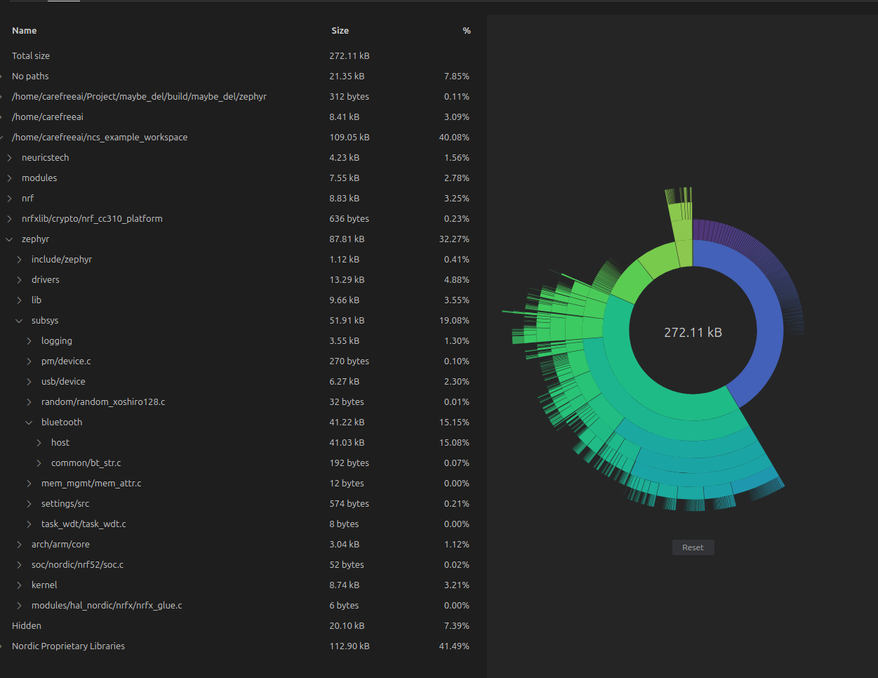

Continuing from last time. After some optimization, the program was able to work. However, after verification, the program could only operate normally for a few hours and then failed to run properly. The phenomenon was manifested as: the USB-related connection was directly disconnected and could not be restored by itself.
After verification, I found that the main reason is that this issue is triggered when multiple connections are in progress simultaneously.
Here is my code.
An error indicates insufficient memory, but even though I set a larger memory, this error still occurs.
I modified some code to disable the previous BLE restart function, and at the same time, I turned off the CODED and 2M PHY switching functions.
Here is my log:

  • I have found out the reason why the system stopped working. It is because after adding the failed connection device to the timeout, due to the large number of unconnected devices, it may not be possible to add additional devices, so a second attempt to connect will be made. At this time, there will be a task_wdt error.
    if(dev_count_connect == CONFIG_BT_CTLR_SDC_PERIPHERAL_COUNT || dev_count_timeout == CONFIG_SERVER_CLIENT_WAITING_COUNT)
            printk("[FULL DEVICES].\n");
            return;
    Therefore, the crux of the matter still lies in:
    1. Why can't multiple connections be made simultaneously? I tried to shut down my main communication process, which doesn't perform any device communication lifecycle management, data communication, or upper computer communication, but still couldn't connect at the same time.
    2. Why does a second attempt to reconnect cause the system to crash?
  • As I explained in this post, the error code -12 returned by bt_conn_le_create typically means "Not enough memory" (-ENOMEM). This indicates that the system does not have enough resources (such as heap memory or connection objects) to establish a new connection.
    I see bt_conn_unref() is used the conn_callbacks, but it didn't get registered. Please study the Central Multilink sample and review your code.
  • 1.
    CONFIG_SYSTEM_WORKQUEUE_STACK_SIZE=3072
    CONFIG_HEAP_MEM_POOL_SIZE=8192
    CONFIG_MAIN_STACK_SIZE=8192
    CONFIG_BT_MAX_CONN=5
    CONFIG_BT_CTLR_SDC_PERIPHERAL_COUNT=4
    I think my memory is sufficient. And all my threads create memory separately.
    K_THREAD_DEFINE(SMF_THREAD_ID, SMF_THREAD_STACK_SIZE, SMF_THREAD, NULL, NULL, NULL, SMF_THREAD_PRIORITY, 0, 0);
    K_THREAD_DEFINE(MAIN_SMF_THREAD_ID, SMF_THREAD_STACK_SIZE, MAIN_SMF_THREAD, NULL, NULL, NULL, SMF_THREAD_PRIORITY + 2, 0, 0);
    k_work_queue_start(&o->network_workq, o->net_workq_stack, K_THREAD_STACK_SIZEOF(o->net_workq_stack), WORKQUEUE_PRIORITY + 1, NULL);
    k_work_queue_start(&o->uart_workq, o->uart_workq_stack, K_THREAD_STACK_SIZEOF(o->uart_workq_stack), WORKQUEUE_PRIORITY + 3, NULL);
    k_thread_create(&o->uart_thread, o->uart_stack_area, K_THREAD_STACK_SIZEOF(o->uart_stack_area), MAIN_UART_THREAD, o, NULL, NULL, SMF_THREAD_PRIORITY + 4, 0, K_NO_WAIT);
    I have no idea where the memory will be occupied.

  • carefree said:
    "bt_hci_core: Connection creation timeout triggered."
    Did you get on the peripheral side or the central side? Could you update the error log on both sides?
    Could you try to debug and ensure that the bt_conn_unref() is executed when the connection fails in your project?
