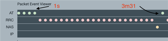

After some difficulty in obtaining the modem trace file, I'm here to have help about connectivity issue. I have a custom board build with an nRF9151, I use Onomondo softSim. So my issue is strange, on my custom board the first LTE event/connect always appears after 3m30/3m35.
Here is an termina output example, as you can see, event coming around 3m30. I did maybe 20 test, different day, etc, and it always take 3m30...

Return of CESQ after LTE connected
+CESQ: 99,99,255,255,15,54
And return of AT+CGMR
mfw_nrf91x1_2.0.2
3056.test_rtt.bin
Is it normal? For example with DK board first LTE event coming at about 1min...
It's look like my modem do nothing between 1s and 3min and half, the only things I see lot of RRC event during 3min and half

    simon884 said:
    If I understand well the link you provide, using lte_lc_power_off() can offer speed connectiona fter the first connection? Should lte_lc_power_off() save in nvm? What happened if I totaly loss power?
    lte_lc_power_off() is setting the modem to power off state. When modem is powered off, certain AT command configuration and network information is preserved in NVM and available even after reset (more information can be found here). This could decrease connection establishment time after first connection.
