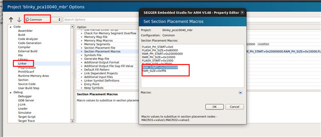

BLE NRF52805 DFU bootloader can't jump to the app
Setup: SDK 17.1.0, SES 8.2, S112, custom buttonless uartless nrf52805 board, non-BLE test apps.
Objective: To enable robust wireless image download as next batch of boards will have debug interface removed. Security doesn't matter at all
Problem: I can't make secure bootloader to jump to app.
Description
I took BLE secure bootloader as a basis despite of extrta security steps which are not needed but hoping it would work out-of-the-box.
By following this guide, I have successfully built debug version of the bootloader. In addition, I have created a test app by slimming random number generator example so the app takes only 8k of flash. My custom application is also tiny. None of the apps require softdevice so the upgrade is only for the app itself.
The bootloader seems to be working as 'advertised' - DFU app (Android phone) works without any issues, bootloader RTT messages look just fine during upgrade, but nothing happens after that.

    I don't think it's what's causing the problem with not booting the app in this, but please use Segger Embedded Studio version 5.x to build your app and bootloader as versions 6.20 and later have known compatibility issues with this SDK.
    If I generate bootloader setting and program them as well, the bootloader never starts DFU even on a blank (erased) chip with the same message as above.
    Judging by the power consumption (about 2.5ma)  nrf52805 is stuck in some sort of waiting loop or similar.

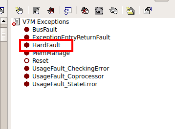

    I recommend you start a debug session in SES and pause the debugger when you have reached this state. You can then check the Program Counter register (PC) in the register view to determine where the code hangs.
    Is there some bootloader/app integration guide? Or bootloader is smart enough to relocate off-the-shelf app to jump to?
    The bootloader is branching to address 0x1000 + 4 which is the address of the Softdevice's reset handler, so this is correct.
    What NO_VTOR_CONFIG actually does? Just sets vector table? I presume Softdevce sets vector table so both bootloader and app should be compiled with NO_VTOR_CONFIG?
    The SES startup code will set the VTOR register to match the start address of the application unless NO_VTOR_CONFIG is set. VTOR needs to be =0 when working with the Softdevice to ensure interrupts are received by the MBR/Softdevice and not just the application.
    Another thing to keep in mind is that the MBR/Softdevice uses the first to words of RAM even if the application is not enabling the Softdevice. This means that you should reserve the first 8 bytes of RAM in your application by setting the RAM start address to 0x20000008 or more. E.g.,
    (Note: RAM_SIZE must not exceed total RAM on device - 8).
    Vidar
