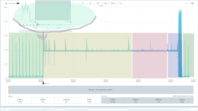

    test tube Power trace analysis (see attached screenshot):
    I’ve recorded the device’s current draw during the event and divided it into five zones:
    First green zone
    The device loses its parent and performs 12 data request attempts. This is expected and the current consumption is acceptable.
    Yellow zone
    After the final attempt, the current draw rises to ~4 mA.
    After ~500 ms, I receive multiple ZB_BDB_SIGNAL_DEVICE_REBOOT signals.
    At the end of this phase, a failed ZB_BDB_SIGNAL_TC_REJOIN_DONE event is received, and the device stops transmitting anything over the air — but power consumption remains high, which I’d like to avoid.
    Red zone
    I power on the coordinator again and send requests to the switch, but it does not respond or reconnect. Current consumption still remains ~4 mA.
    Purple zone
    I press a button on the switch, triggering a Zigbee message. Only then does the device reconnect and resume normal behavior.
    Final green zone
    The device returns to low-power mode (~10 µA), as desired.

    • You mentioned calling stop_network_rejoin() as a possible solution. However, when I attempt to call this function directly in my application, I get a compilation error — the symbol is not declared.
    • Before I resort to patching the SDK or copying internal logic, may I ask:
    • Is there a supported way to stop or influence the rejoin process from application code, or at least hook into the logic to prevent high power consumption?
      (It’s not critical to stop rejoining — but I want to avoid unnecessary current draw while it’s happening or after it fails.)
    • Alternatively, can I use the ZB_BDB_SIGNAL_TC_REJOIN_DONE event with failure status to shut down the radio and enter deep sleep (timer- or button-based wakeup), as a workaround?

    This is not a graceful option, but a possible test could be to enable CONFIG_ZIGBEE_DEBUG_FUNCTIONS to use debug functions to suspend the ZBOSS thread with zigbee_debug_suspend_zboss_thread()
    MAndris said:
    Is it possible to achieve the same behavior (deep sleep + wake on timer) using Zigbee-specific mechanisms?
    For example, could the device switch to a different role (like Green Power or commissioning-only mode) instead of fully powering down?
    There is a weak function zb_osif_sleep which can be redefined to your requirements of deep sleep. The input parameter sleep_tmo should be in ms as far as I can tell. You can see the implementation in zb_nrf_pwr_mgmt.c
    MAndris said:
    Is there a recommended sequence for entering System OFF with both GRTC timer and GPIO latch as wake-up sources, after Zigbee has started or failed to rejoin?
    Not sure about this, so I need some more time to check.
    Maria
