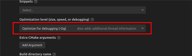

    You can select this option in your build configuration to make debugging easier:
    Then start a debug session and use the call stack view after the crash is triggered to trace back to where the problem occurred.
