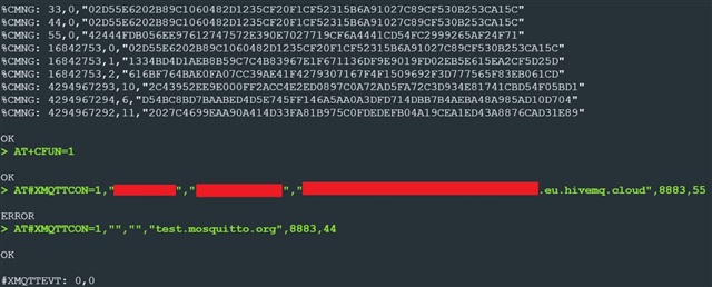

I am using and nrf9160, in particular a thingy91. It is running 1.3.7 firmware.  I have the SLM sample loaded and can sent AT commands to the device using the nRF Serial Terminal and Cellular Monitor applications.
I have been successful connecting to test.mosquitto.org through AT commands using port 8883 and a certificate loaded using the Cellular Monitor certificate manager.
I am now trying to connect to a hiveMQ cloud server. I followed the same steps but have not been able to connect. The AT#XMQTTCON just returns ERROR
I have seen a few articles that show this exact connection setup but I have not had any luck. Any help would be great.

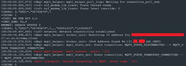

    Have you tried connecting to HiveMQ using one of the simpler MQTT samples?
  • Hi Benjamin,
    I tried the connection with the MQTT sample from ncs 2.8.0. Looks like the connection is refused.
    I had to modify the example to use the username and password. I edited the transport.c file and added to the conn_params variable:

    Is it possible that this is an issue with the certificate? I have used it with other devices and had no issue (ESP32 over wifi and Quectel BG95 LTE).
    I have had problems in the past with Server Name Indication (SNI)  when connecting to these hiveMQ servers. Any way to tell why the connection is refused?
