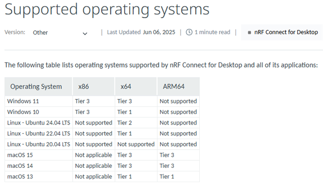

I'm migrating my development environment to arm-based Mac. I succeed to install nRF Connect for Desktop app for aarch64 architecture, but struggling to get Bluetooth Low Energy app for aarch64, only x86(intel). That cause issues with JLink drivers as I install JLink drivers only for aarch64. I get used to that app back on intel based Mac and used it extensively. Is there nRF Connect Desktop for Bluetooth Low Energy app native for Arm-based Mac at all? Or I did something wrong?
  • Hi Sergey
    I'm currently waiting on a reply from the developers on this to confirm, but it seems that x86 macOS is not applicable for support based on the operating systems table from our documentation:
    I'll get back to you with a definitive answer though.
    Simon
    UPDATE: The developers confirmed that we are not supporting the BLE app on Arm-based Mac, nor are there any plans to support this. Please contact the Nordic sales manager of your region if you have questions on escalation/roadmaps for upcoming features. I'm very sorry about the inconvenience this causes for you.
