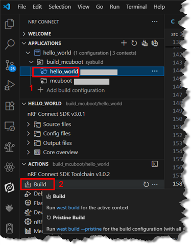

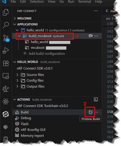

To flash the device for the first time, I’ll perform a pristine build. In VS Code, I’ll select the build folder, both for the application and the MCUBoot bootloader, and make the pristine build using the ACTIONS tab as is shown in the image below.
If I only need to update the application code (without making any changes to my custom board's .dts or .dtsi files, modifying the prj.conf, or touching the bootloader code) I can simply update the VERSION file, select the application folder in my build configuration and perform a standard build, as shown in the image below.
Could you please confirm whether the above procedures were followed correctly, or if I’ve overlooked something?
