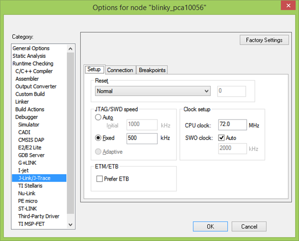

  • After some poking around in EWB I found where I can set JTAG speed: Project -> Options... -> J-Link/J0-Trace.
    I tried many different manual values between 100 kHz and 1250 kHz to no avail.  The only thing changed that I no longer get the "Auto speed detection..." message, which is fully expected.
