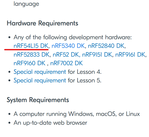

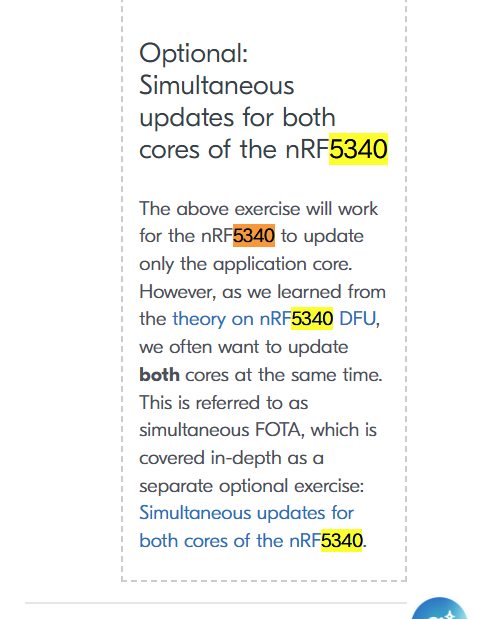

    So firstly, the elephant in the room … why is there no example for FOTA using the external flash memory and the 54L part?
    In general there are samples, but most of the samples showcasing FOTA in NCS also showcases (mainly) other things.
    The main problem is that existing materials appear incompatible with the 54L range of parts, so following guides and dev academy materials proved somewhat frustrating.

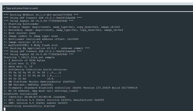

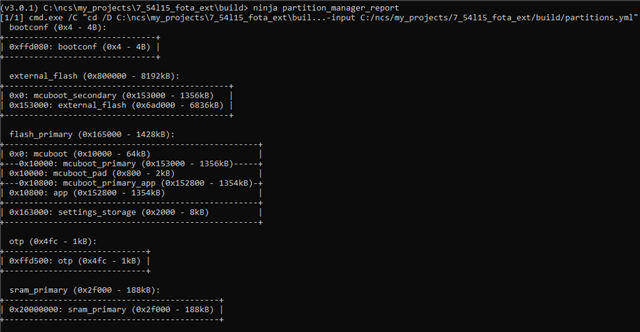

  • Hi again,
    I've had a brief look through your zip and I've created a sample for you that compiles, builds and flashes (tested on nrf54l15dk/nrf54l15/cpuapp)
    Sample goes through the booting process and starts advertising as expected
    And the partition manager sets up the secondary mcuboot partition for the update image on the SPI connected external flash device:
    Please compare this sample to your solution and let me know if you're able to spot any differences between this zip and your project

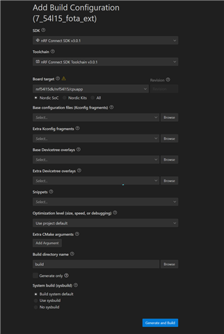

  • Hello again Andreas.
    I had high hopes ....  Opened your file and tried to build.
    -- Configuring done
    -- Generating done
    -- Build files have been written to: C:/Work/7_54l15_fota_ext/build/7_54l15_fota_ext
    [1/329] Generating include/generated/zephyr/app_version.h
    -- git describe failed: fatal: not a git repository (or any of the parent directories): .git
    [5/329] Generating include/generated/zephyr/version.h
    -- Zephyr version: 4.0.99 (C:/ncs/v3.0.1/zephyr), build: v4.0.99-ncs1-1
    [324/329] Linking C executable zephyr\zephyr_pre0.elf
    FAILED: zephyr/zephyr_pre0.elf zephyr/zephyr_pre0.map C:/Work/7_54l15_fota_ext/build/7_54l15_fota_ext/zephyr/zephyr_pre0.map
    cmd.exe /C "cd . && C:\ncs\toolchains\0b393f9e1b\opt\zephyr-sdk\arm-zephyr-eabi\bin\arm-zephyr-eabi-gcc.exe  -gdwarf-4 @CMakeFiles\zephyr_pre0.rsp -o zephyr\zephyr_pre0.elf -L"c:/ncs/toolchains/0b393f9e1b/opt/zephyr-sdk/arm-zephyr-eabi/bin/../lib/gcc/arm-zephyr-eabi/12.2.0/thumb/v7e-m/nofp" -lc -lgcc && cmd.exe /C "cd /D C:\Work\7_54l15_fota_ext\build\7_54l15_fota_ext\zephyr && C:\ncs\toolchains\0b393f9e1b\opt\bin\cmake.exe -E true""
    c:/ncs/toolchains/0b393f9e1b/opt/zephyr-sdk/arm-zephyr-eabi/bin/../lib/gcc/arm-zephyr-eabi/12.2.0/../../../../arm-zephyr-eabi/bin/ld.bfd.exe: zephyr/libzephyr.a(flash_map_partition_manager.c.obj):(.rodata.default_flash_map+0x1c): undefined reference to `__device_dts_ord_131'
    c:/ncs/toolchains/0b393f9e1b/opt/zephyr-sdk/arm-zephyr-eabi/bin/../lib/gcc/arm-zephyr-eabi/12.2.0/../../../../arm-zephyr-eabi/bin/ld.bfd.exe: zephyr/libzephyr.a(flash_map_partition_manager.c.obj):(.rodata.default_flash_map+0x6c): undefined reference to `__device_dts_ord_131'
    [10/20] No configure step for 'mcuboot'
    FAILED: _sysbuild/sysbuild/images/7_54l15_fota_ext-prefix/src/7_54l15_fota_ext-stamp/7_54l15_fota_ext-build C:/Work/7_54l15_fota_ext/build/_sysbuild/sysbuild/images/7_54l15_fota_ext-prefix/src/7_54l15_fota_ext-stamp/7_54l15_fota_ext-build
    cmd.exe /C "cd /D C:\Work\7_54l15_fota_ext\build\7_54l15_fota_ext && C:\ncs\toolchains\0b393f9e1b\opt\bin\cmake.exe --build ."
    FATAL ERROR: command exited with status 1: 'C:\ncs\toolchains\0b393f9e1b\opt\bin\cmake.EXE' --build C:/Work/7_54l15_fota_ext/build

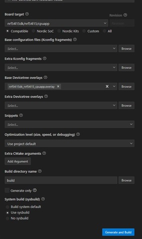

    I double checked that I could build it with VS Code extension and not just in command line and it build out of the box for me using this configuration.
    I see that you have an overlay in the image you attached. Could you
    1. Delete any build folders that are within the project you're currently working with so that we ensure a completely pristine build
    2. Build with the same setup as I've done in the image pasted above
    Andreas
  • Hi Andreas .... and apology!
    I glazed over the build setup and did not pick up that it was automatically selecting the wrong CPU/board. (82 part)  I thought it would have selected the 54L as that was the board we dealing with.  Completely missed that detail.
    I can confirm that it compiles fully without errors.   Thank you once again.
    I still need to go over the detail you provided in previous message in order that I can make sense/learn how you put  this together.    Thank You again.  I think you could close this thread now.   If I find anything else, can start something new for that.
    Regards
    Brian
  • Great! Glad to hear that the firmware is compiling on your end as well!
    I will mark this case as resolved for now, but feel free to ask follow up questions. I will however be OoO from tomorrow for a few weeks, so a reply should come faster from our side if you create new cases than if you reply with a follow up here
    Andreas
