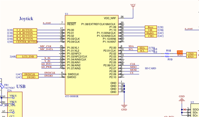

Background - We are laying out a new board, upgrading to the nRF54, and wanted to use p2.02 and p2.03 as serial UART lines because p1.04 and p1.05 were planned to be used as analog inputs. We could do another board spin to swap these ADCs with the UART, and move some other pins, but I wanted to make sure that will work before we make more hardware changes.
Current state - I have written a device tree overlay for the nRF54L15 (moved from a nRF52840) to set up our peripherals. While testing UART, I noticed there was garbage on the TXD and nothing I was sending from my computer is registering or echoing back on the device. I've tried other microcontrollers and other cables. The waveform looks decent, a little ringing, but upon closer inspection there seems to be a bit  of clock stretching and data clobbering. My scope can't decode the data, either.
The TXD signal line occasionally destabilizes after the device stops transmitting data. I think this is correct because it's supposed to be an open drain, and only RXD gets a pull-up biasing, right?
So my questions -
  • Is this current setup possible with pinmuxing?
  • Are there external physical line requirements?
  • Is the better solution to swap back to the default uart20 pins and move other pins around?
  • Could I put the pins on another device like uart21 or uart30?
  • Are there other unknowns about p2 pins and their ability to mux with various I/O?
  • Should the device be configured for UART Async or UART Interrupt driven? I've tried both and they appear the same.
Relevant schematic:

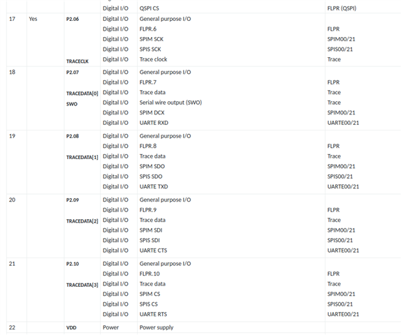

    Please refer to the documentation on Dedicated pins and Cross power-domain use and the relevant pin assignment table for your package variant. Sorry that this was so short, I'll be able to elaborate later if the linked documentation is not enough.
    Maria
  • So if I'm reading the pin assignment table correctly, pins on P2 have special dedications. Should I make the following changes to correctly assign with the power domain constraints?
    UART20
    TXD  -> P2.02 (no change)
    RXD  -> P2.07
    SPI00/SDHC
    CLK  -> P2.06 (no change)
    MISO -> P2.08
    MOSI -> P2.09
    CS   -> P2.10
    I tried these changes and stopped getting clobbered output only when I changed from a logging thread to an immediate log mode, but I still don't get any feedback on RXD, even on P2.07.

  • Found a mistake in my last follow up - For my setup I need to rearrange a few things. The pins above are the new mapping.
    UART20->UART00
    SPI00->SPI20
    This allows me to use UART and SPI without making too many hardware changes. The following is my working overlay. I still may try to use a logging thread but I'm going to stick with immediate mode for now. UART is not necessarily critical to the final product, but it is very important for development.
