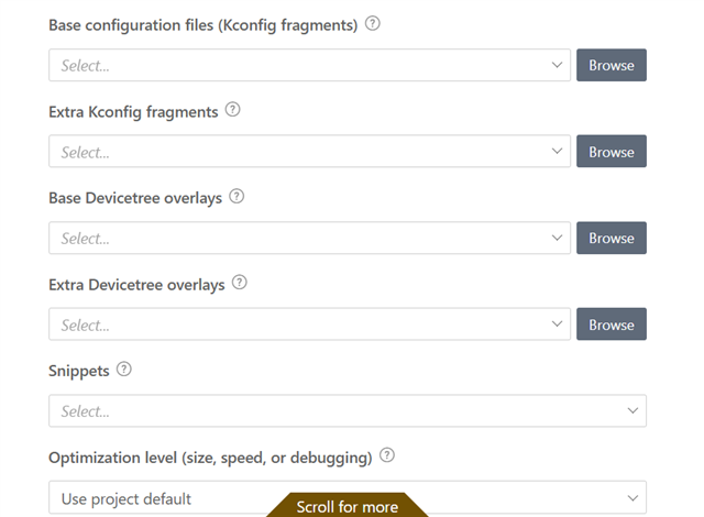

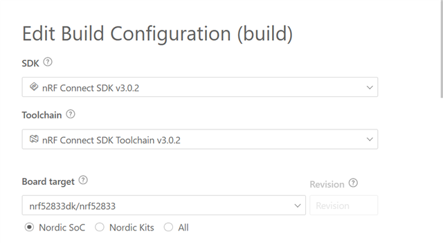

  5. built a configuration

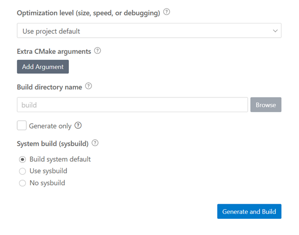

This is our build configuration

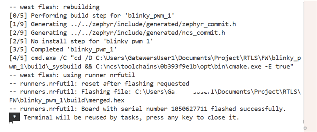

After building and flashing the board We dont see any LED of the ones in the DK blinking .

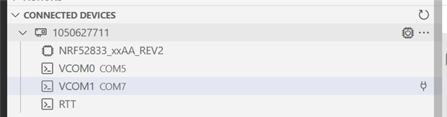

This is our "connected devices" section

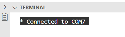

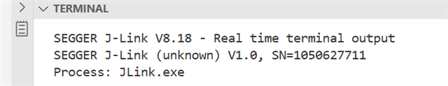

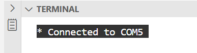

Even if we connect on both COM we dont see any string
The only one wich seems to be ok is the JLINK

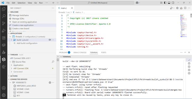

I post the "Flash" output which is ok

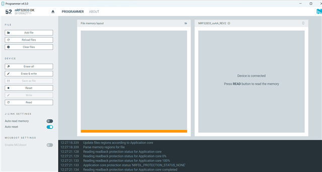

We also tried to reset the board from IF BOOT/RESET button but nothing happens.
