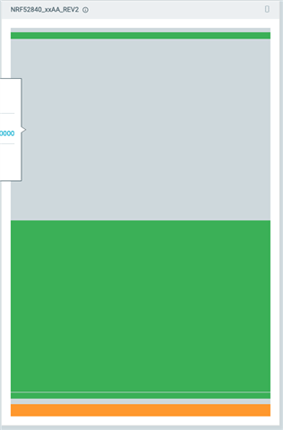

prj.conf (partial):
CONFIG_PARTITION_MANAGER_ENABLED=y
CONFIG_PM_OVERRIDE_EXTERNAL_DRIVER_CHECK=n
CONFIG_PM_EXTERNAL_FLASH_MCUBOOT_SECONDARY=n
CONFIG_PM_PARTITION_REGION_LITTLEFS_EXTERNAL=y
pm_static.yml (simplified):
mcuboot: 0x00000 - 0x0c000
mcuboot_primary: 0x0c000 - 0x84000
mcuboot_secondary: 0x84000 - 0xfc000
settings_storage: 0xfc000 - 0x100000
My questions:
  1. What could prevent MCUboot from initiating the swap even when magic/swap_info are written? (Could a mismatch in partition maps between MCUboot and the application prevent the swap?)
  2. Is there a correct way to attach to MCUboot for runtime debugging? (e.g., debugging from reset?)
  3. Any known issues with OTA DFU + MCUboot + CONFIG_DISABLE_FLASH_PATCH?
  4. Are there additional configs I should double-check?
  5. How can I verify that MCUboot has the correct view of the flash layout?
Thanks in advance — happy to share more if needed!

    Regarding the size my firmeware is near the limit from 473kb. but already tried it with a blinky with the same signed key and the same issue!
    My layout on the programm looks wired. (maybe this is a hint)

    I see that you're not intending to use external flash for the update image (SB_CONFIG_PM_EXTERNAL_FLASH_MCUBOOT_SECONDARY=n), is this correct?
    Secondary:
    Could you verify you have a b0 or not? If you are, then this might be a fix for you https://github.com/nrfconnect/sdk-nrf/pull/22454
    Could you examine the mcuboot image headers are included in the hex either with https://docs.nordicsemi.com/bundle/ncs-latest/page/mcuboot/imgtool.html or by following the suggestions here: https://devzone.nordicsemi.com/f/nordic-q-a/111974/mcuboot-loses-pending-update-image-in-slot-1-after-reset?ReplyFilter=Answers&ReplySortBy=Answers&ReplySortOrder=Descending
    Andreas
