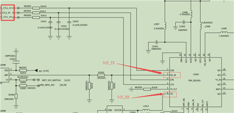

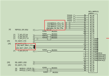

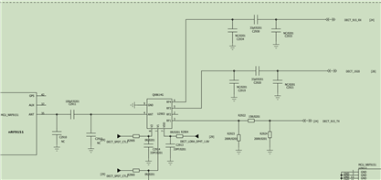

    SE2435L was used as the PA,SE2435L was used as the PA, while QX8614G was used for channel switching.
    May I ask if the PA circuit design in the above picture is correct? Our hardware engineer has raised questions about the NRF9151 dect PA circuit design in another case, but has not received a definite response yet.So, it is currently uncertain whether this PA circuit can function properly.
