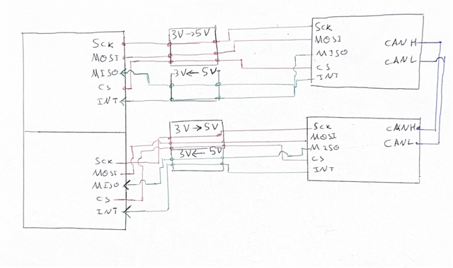

Hi everyone,
I’m trying to bring-up a very small CAN bus test bench built with two Nordic nRF5340 DKs (application core only).
Each DK is wired to the usual “all-in-one” MCP2515 + TJA1050 8 MHz breakout board, through a 3 VLeft right arrow5 V level-shifter.
Both DKs share CAN H/L and 120 Ω termination, so the setup is basically:
nRF5340 DK #1  <--SPI3-->  MCP2515 board  <--TJA1050-->  CAN bus
nRF5340 DK #2  <--SPI3-->  MCP2515 board  <--TJA1050-->  CAN bus
I’m on Zephyr 4.1.99 (built from current main), using the in-tree MCP2515 driver.
Symptoms
  • can_start(can_dev) returns -5 (-EIO) every time.
  • When I manually read the registers right after a software reset I get
    CANCTRL = 0xFF
    CANSTAT = 0xFF          (sometimes 0x00 after I keep CS low)
    which looks like no response from the MCP2515 at all.
  • With an oscilloscope I can see SCK ≈ 1 MHz and MOSI activity,
    but CS stays low (driver-controlled) and MISO never toggles.
What I already tried
  • Verified 5 V on MCP2515 VDD and 8 MHz crystal is running.
  • Forced a software reset sequence (0xC0), small delay, then raw SPI read of CANSTAT → still 0xFF/0x00.
  • Added explicit bit-timing for the 8 MHz crystal (250 kbit/s) before can_start()no change.
  • Toggling CS manually in the application proves the pin & level-shifter work; as soon as the driver owns CS it sits low.
  • Moving the module to a spare STM32 board shows it is alive, so the hardware itself is OK.

Question
What else should I check?
  • Is there something obvious in my overlay / pinctrl that would keep CS low?
  • Do I have to patch the MCP2515 driver for an 8 MHz oscillator (BRP tables)?
  • Any clue why the device just returns 0xFF on every read (→ tri-stated MISO)?
I’d be grateful for any hint
