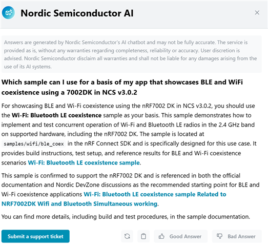

    After this (or atleast not before after the 2nd item), I would've started with finding a sample that I could base my application on. Here you can prompt Kapa for input, for instance as follows:
    The resulting sample: https://docs.nordicsemi.com/bundle/ncs-latest/page/nrf/samples/wifi/ble_coex/README.html, which you also can find here: https://github.com/nrfconnect/sdk-nrf/tree/main/samples/wifi/ble_coex
