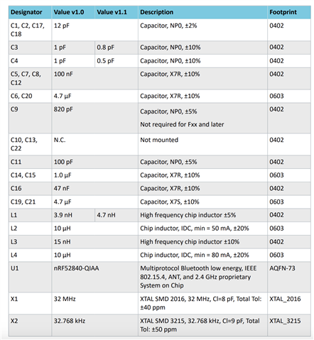

nRF52840 reference circuitry metric or imperial units?
Super quick but important question, are the SMD footprints in the nRF52840 reference circuitry recommended BOM (ie image attached) in imperial or metric units? and just curious since I'm relatively new to this, what is the convention when the datasheet doesn't specify? Thanks!
