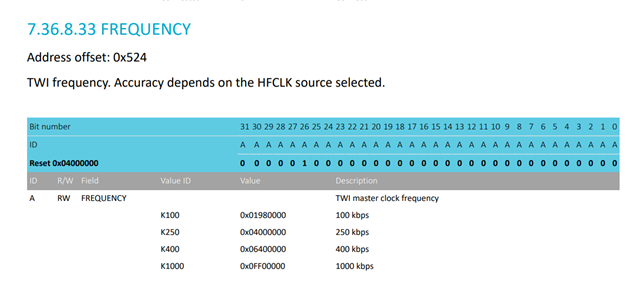

Hi -
I'd like to set the i2c to clock in at no more than 2 khz.   Are there FREQUENCY register settings that would work for this.  In addition, is there a reference as to how the FREQUENCY register is calculated for a desired i2c clock rate?
Dave
