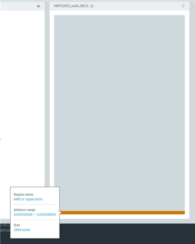

  • OK, I checked again and got the following result:
    PS C:\Users\hoko> nrfjprog --deviceversion
    483012109 - NRF52833_xxAA_REV2
    PS C:\Users\hoko> nrfjprog --recover
    Recovering device. This operation might take 30s.
    Erasing user code and UICR flash areas.
    Writing image to disable ap protect.
    PS C:\Users\hoko> nrfjprog --memrd 0x00000000 --n 16
    0x00000000: 20020000 0000057D 000
    I think I may have applied other protection. Is there a way to check?
  • No, you would not have been able to read from the FLASH if readback protection was still enabled.
    This is the beginning of the firmware image that is loaded after the chip is erased here:

    The "recover" command will first erase the chip through the CTRL-AP then it will load a small FW binary which will do the SW unlocking of the approtect mechansim.
    Please clarify what you're trying to do or achieve.
  • OK, I see what I don't understand. Could you please show me a document that explains "This is the beginning of the firmware image that is loaded after the chip is erased here:"? I'll study it.
  • I just wanted to erase all mem, and the steps below seem to have done the trick, so I think I'll go ahead with this. Thank you so much for your support.
