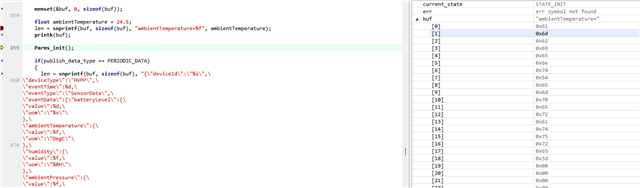

    1. In our application we will store 5000 records and each record of size 1429, hence total bytes=5000 *      1429=7145000. Hence, we are planning to transfer 7.145MB in single MQTT publish. It is possible right?
    2. When I am copying float value into buf using sprintf I am not seeing any value in the buffer, why? whereas %d is working but %f is not working. Am I missing anything, please advice.
    float ambientTemperature = 24.5;
    len = snprintf(buf, sizeof(buf), "ambientTemperature=%f", ambientTemperature);
    printk(buf);

  • Hi Sravan,
    Which MQTT broker do you use?
    If you use picolib, ensure that PICOLIB_IO_FLOAT is enabled.

  • Hi Dejan,
    I am using tago.io broker.
    I am saying that snprintf itself not copying the float value into buffer when I use %f.
    Sravan Rikka

  • Hi Sravan,
    Have you checked if there are any limitations on the broker side?
    printk(buf);
    I have used the following sample which correctly displays ambientTemperature value from the buffer buf.
    #include <stdio.h>
    char buf[200];
    int len;
        printf("buffer value is %s", buf);
    Dejan
