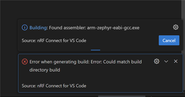

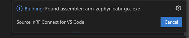

Found assembler: arm-zephyr-eabi-gcc.exe.
toochain:3.0.2  sdk3.0.2  nrf connect
Every time I build, it gets stuck here: Found assembler: C:/ncs/toolchains/0b393f9e1b/opt/zephyr-sdk/arm-zephyr-eabi/bin/arm-zephyr-eabi-gcc.exe. Below is the complete log:

why?
    What do you mean by "the build gets stuck at this point"? Does that mean the build doesn’t progress beyond this step?

  • yes,the build doesn’t progress beyond this step,there must be something wrong with my local environment, but I’m not sure how to troubleshoot it. Could you please provide some ideas or steps for diagnosing the issue?
    Have you tried any other samples from the SDK? Does the same issue occur with the other samples, or is it only happening with this particular one?
    Abhijith
  • hi Menon, i uninstall Fei Lian in my pc, it works well, It looks like Fei Lian intercepted the compilation, thoanks for your help!
