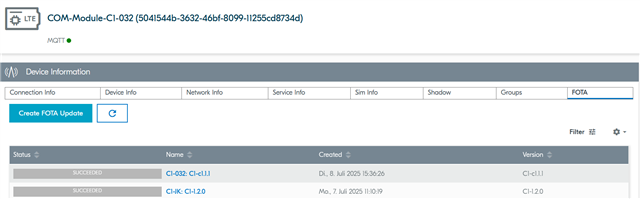

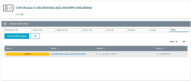

  • Hi Dejan,
    We noticed the issue about 3 weeks ago -- the update to that device was listed as "QUEUED" for about 2 weeks. Then, a week ago, the device suddenly updated. As far as we know, nothing on our side changed, except that the device was power-cycled three or four times during the 2 weeks for different reasons. The last power cycle seemed to have triggered the OTA.
    The device was working as expected all the time, sending data to the cloud.
    At the core, our application is build on the multi-service example. The OTA job is created and deployed in the nRF Cloud UI. After deploying, the OTA usually is executed by a device within a minute. We have done about 100 OTA updates this way, and they worked fine. It's just this one device so far that took much longer than expected.
    I've attached two screenshots:
    1. The OTA job deployed on Jun 13
    2. The OTA job on Jul 7 it finally succeeded (note: We did another OTA the following day on Jul 8 as a test, that succeeded quickly, as expected).
