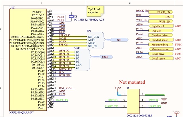

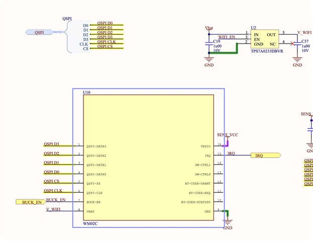

Issue with Wi-Fi TX on Custom PCB (nRF5340 + nRF7002)
On our custom PCB, we’re using an nRF5340 and an nRF7002 via the WM02C module.
In our devicetree, we are using the following QSPI node configuration.
We’ve produced 10 custom PCBs, and on 5 of them the Wi-Fi works perfectly. Both the SoftAP and Wi-Fi Shell samples run without any issues.
However, on the remaining 5 boards, it seems like there are transmission issues (TX). The module is able to perform a Wi-Fi scan and correctly lists all nearby access points with strong RSSI values. But when trying to connect to any of them, it never receives a response from the AP, most likely because the nRF7002 isn’t transmitting anything.
When flashing the SoftAP sample, there are no errors in the log, and everything appears to work correctly. But no devices (e.g., phone or computer) can detect the access point being broadcast.
Does this sound like a software issue, or is it more likely to be a hardware problem?
Here is the device tree and and pcb schematics.
nrf5340_cpuapp_common.dtsinrf5340_cpuapp_common_pinctrl.dtsi

    The device that works has MAC: 00:18:07:01:69:0E
    The device that doesnt work has MAC: 00:18:07:01:6E:76
    The WIFI i'm connecting to is using (channel 1: 2.4GHz) and (channel 44: 5GHz)
    I have done following tests while sniffing the wifi:
    For working device:
    (file names endig with success)
    1. Snif on channel 1 while doing active wifi scan
    2. Snif on channel 1 while connecting to channel 1
    3. Snif on channel 44 while doing active wifi scan
    4. Snif on channel 44 while connecting to channel 44
    For device with the error:
    (file names endig with fail)
    5. Snif on channel 1 while doing active wifi scan
    6. Snif on channel 1 while connecting to channel 1
    7. Snif on channel 44 while doing active wifi scan
    8. Snif on channel 44 while connecting to channel 44
    wifi sniffer results.zip
    The wifi scan seems to work on both devices but wifi connect gives the following console log from the bad device:
    Connection requested
    [00:00:45.875,701] <inf> wpa_supp: wlan0: SME: Trying to authenticate with 8a:2a:a8:4b:a5:80 (SSID='MoveDevices' freq=5220 MHz)
    [00:00:50.880,462] <inf> wpa_supp: wlan0: Added BSSID 8a:2a:a8:4b:a5:80 into ignore list, ignoring for 10 seconds

    uart:~$ wifi connect -s "MoveDevices" -p "*******" -k 1 -w 1 -c 44 -b 5
    [00:00:12.881,500] <dbg> wifi_nrf: zep_shim_pr_dbg: nrf_wifi_hal_ctrl_cmd_send: caller 0x6f681
    [00:00:12.889,862] <dbg> wifi_nrf: zep_shim_pr_dbg: umac_cmd_cfg: Command 0 sent to RPU
    [00:00:12.891,174] <dbg> wifi_nrf: zep_shim_pr_dbg: nrf_wifi_fmac_event_callback: Event type 3 recd
    [00:00:12.891,235] <dbg> wifi_nrf: zep_shim_pr_dbg: umac_event_ctrl_process: Event 257 received from UMAC
    [00:00:12.891,296] <dbg> wifi_nrf: zep_shim_pr_dbg: umac_event_ctrl_process: Event 257 processed
    [00:00:12.891,326] <dbg> wifi_nrf: zep_shim_pr_dbg: nrf_wifi_fmac_event_callback: Event type 3 recd
    [00:00:12.891,387] <dbg> wifi_nrf: zep_shim_pr_dbg: umac_event_ctrl_process: Event 292 received from UMAC
    [00:00:12.891,418] <dbg> wifi_nrf: zep_shim_pr_dbg: umac_event_ctrl_process: Command 0 -> status 0
    [00:00:12.891,448] <dbg> wifi_nrf: zep_shim_pr_dbg: umac_event_ctrl_process: Event 292 processed
    [00:00:42.890,258] <dbg> wifi_nrf: zep_shim_pr_dbg: nrf_wifi_hal_ctrl_cmd_send: caller 0x6f681
    [00:00:42.892,242] <dbg> wifi_nrf: zep_shim_pr_dbg: umac_cmd_cfg: Command 1 sent to RPU
    [00:00:42.892,517] <dbg> wifi_nrf: zep_shim_pr_dbg: nrf_wifi_fmac_event_callback: Event type 3 recd
    [00:00:42.892,547] <dbg> wifi_nrf: zep_shim_pr_dbg: umac_event_ctrl_process: Event 260 received from UMAC
    [00:00:42.892,608] <dbg> wifi_nrf: zep_shim_pr_dbg: umac_event_ctrl_process: Event 260 processed
    [00:00:42.894,348] <dbg> wifi_nrf: zep_shim_pr_dbg: nrf_wifi_hal_ctrl_cmd_send: caller 0x6f681
    [00:00:42.895,660] <dbg> wifi_nrf: zep_shim_pr_dbg: umac_cmd_cfg: Command 0 sent to RPU
    [00:00:42.895,782] <dbg> wifi_nrf: zep_shim_pr_dbg: nrf_wifi_fmac_event_callback: Event type 3 recd
    [00:00:42.895,812] <dbg> wifi_nrf: zep_shim_pr_dbg: umac_event_ctrl_process: Event 292 received from UMAC
    [00:00:42.895,843] <dbg> wifi_nrf: zep_shim_pr_dbg: umac_event_ctrl_process: Command 0 -> status -16
    [00:00:42.895,904] <dbg> wifi_nrf: zep_shim_pr_dbg: umac_event_ctrl_process: Event 292 processed
    [00:01:12.895,935] <dbg> wifi_nrf: zep_shim_pr_dbg: nrf_wifi_hal_ctrl_cmd_send: caller 0x6f681
    [00:01:12.897,888] <dbg> wifi_nrf: zep_shim_pr_dbg: umac_cmd_cfg: Command 1 sent to RPU
    [00:01:12.898,193] <dbg> wifi_nrf: zep_shim_pr_dbg: nrf_wifi_fmac_event_callback: Event type 3 recd
    [00:01:12.898,223] <dbg> wifi_nrf: zep_shim_pr_dbg: umac_event_ctrl_process: Event 260 received from UMAC
    [00:01:12.898,315] <dbg> wifi_nrf: zep_shim_pr_dbg: umac_event_ctrl_process: Event 260 processed
    [00:01:17.898,864] <dbg> wifi_nrf: zep_shim_pr_dbg: nrf_wifi_hal_ctrl_cmd_send: caller 0x6f681
    [00:01:17.901,458] <dbg> wifi_nrf: zep_shim_pr_dbg: umac_cmd_cfg: Command 0 sent to RPU
    [00:01:17.901,580] <dbg> wifi_nrf: zep_shim_pr_dbg: nrf_wifi_fmac_event_callback: Event type 3 recd
    [00:01:17.901,611] <dbg> wifi_nrf: zep_shim_pr_dbg: umac_event_ctrl_process: Event 292 received from UMAC
    [00:01:17.901,672] <dbg> wifi_nrf: zep_shim_pr_dbg: umac_event_ctrl_process: Command 0 -> status -16
    [00:01:17.901,702] <dbg> wifi_nrf: zep_shim_pr_dbg: umac_event_ctrl_process: Event 292 processed
    uart:~$ wifi statistics
    Statistics for Wi-Fi interface 0x2000d200 [1]
    Bytes received   : 0
    Bytes sent       : 0
    Packets received : 0
    Packets sent     : 0
    Receive errors   : 0
    Send errors      : 0
    Bcast received   : 0
    Bcast sent       : 0
    Mcast received   : 0
    Mcast sent       : 0
    Beacons received : 0
    Beacons missed   : 0
    Unicast received : 0
    Unicast sent     : 0
    Overrun count    : 0
    [00:01:37.566,070] <dbg> wifi_nrf: zep_shim_pr_dbg: nrf_wifi_hal_ctrl_cmd_send: caller 0x70249
    [00:01:37.619,720] <err> wifi_nrf: nrf_wifi_fmac_stats_get: Timed out
    Before we analyse the logs, can you please confirm if the MAC address are correct? For e.g., in working device captures from 1-4, I see frames with wlan.addr == 00:18:07:01:6E:76 but this MAC is noted as a not working one? And 5--8 I see the working MAC address?
    -Amanda H.
    I apologize. I see that my previous file overview had the faulty and working devices mixed up. Here is the corrected version:
    Sniffer results for the faulty device (WLAN MAC: 00:18:07:01:6E:76):
    Sniffer results for the working device (WLAN MAC: 00:18:07:01:69:0E):
    - Buster N.
  • From the captures, the team can see below
    1. 2.4G: Probe response received but no Authentication frame seen OTA
    2. 5G: Probe request itself is not seen (and possibly never sent out hence no probe response)
    I would recommend you to use Radio test using VSA to characterize the TX. Please see https://docs.nordicsemi.com/bundle/ncs-latest/page/nrf/samples/wifi/radio_test/multi_domain/testing.html
