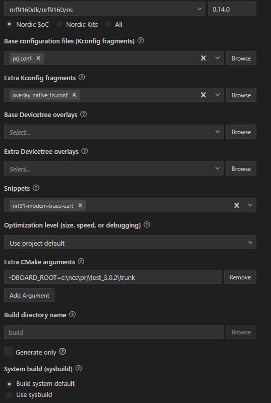

I've also attached both projects, difference is in some new CONFIG_ lines in prj.conf and overlay_native_tls.conf and an mqtt API change.
Build as follows;
