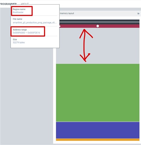

  • Ok, now I managed to enable ReadProtect only the second time after reset because of the Verify issue.
    To manage this, I use a command line before program / verify and check this value in the App:
    nrfjprog --memwr 0x000F5000 --val 0x12345678
    if I read the address before enabling the ReadBackProtection I read 0xDEADC0DE
    nrfjprog --memrd 0x000F5000 0x000F5000: DEADC0DE
    my bootloader is starting at 0xF6000 and has 32kB, so in the memory map the part lower than 0xF6000 should be empty, but what this 0xDEADC0DE is meaning?
    Is it safe to use this region below (grey) or should I avoid this? Is there any other way to do the ReadBackProtection in the App only after the second Reset without this Falsh? UICR is not working, I guess the internal falsh is ok only the 0xDEADC0DE is confusing me...
  • I think it's possible to use NRF_UICR->CUSTOMER[x] flag to enable the NRF_UICR->APPROTECT only after the second Reset/Boot, and with nrfjprog --eraseall the flags in uicr will be reset to default before flashing.I will try
