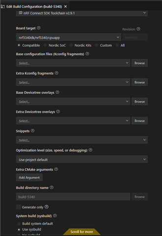

How to add the required conf and overlay files when creating a new build with an existing application

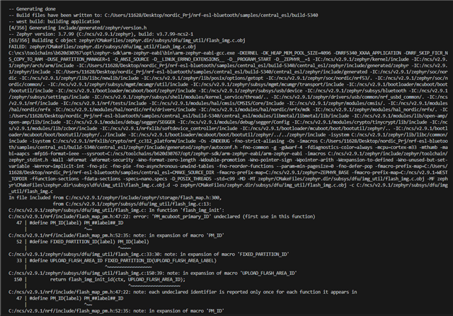

When I was using the code from the following website, I encountered many errors while creating a new build for compilation。
https://github.com/NordicPlayground/nrf-esl-bluetooth
1.There are many conf files and overlay files for compatible chips in the project folder. I am not sure which ones should be added and which ones do not need to be added. Is there any file in this project folder with relevant instructions?

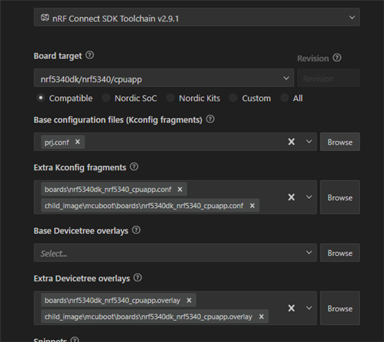

  • There are many conf files and overlay files for compatible chips in the project folder. I am not sure which ones should be added and which ones do not need to be added. Is there any file in this project folder with relevant instructions?
    1.First,The question I most want to know the answer to is "for any application,How to know which conf files and overlay files can be added to the build?“
    The Central ESL sample that you refer to supports the nRF5340 DK with the nrf5340dk_nrf53_cpuapp board name and the nrf5340dk_nrf5340_cpuapp build target, as per the sample description in the documentation provided with the sample.
    2.I kown the Central ESL sample supports the nRF5340_nrf5340_cpuapp board,and Which file are you referring to as the sample description?
    From what I understand, it should not be necessary to add further overlays in the build configuration.
    3.I did not add any files to the build configuration,Compilation error
    I see that you have chosen nRF5340 for the build configuration, but this case is tagged with nRF54L15. Which board are you using? If you build for the nRF53, but use an nRF54L, then the project is not expected to run.
    4.This sample is ultimately applied in nrf54l15,so this case is tagged with nRF54L15.
    It looks like the playground sample might be using nRF Connect SDK v2.5.0, based off of the link to SDK documentation in the sample description (https://developer.nordicsemi.com/nRF_Connect_SDK/doc/2.5.0/nrf/getting_started/programming.html#gs-programming). The error might stem from changes between the SDKs used. You could try selecting the "No sysbuild" option under "system build", but if that doesn't work then you should find the matching nRF Connect SDK version for the sample.
