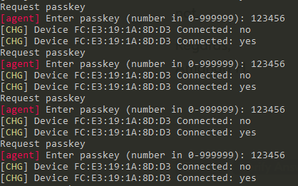

  • If I switch sec_param.io_caps to BLE_GAP_IO_CAPS_DISPLAY_ONLY, it allows the central device (BlueZ) to correctly prompt for passkey input, as shown below.
    However, the peripheral (nRF52840-DK) does not trigger the BLE_GAP_EVT_AUTH_KEY_REQUEST event for unknown reasons. As a result, the defined passkey cannot be used, and pairing fails (Central keeps requesting input repeatedly).
    case BLE_GAP_EVT_AUTH_KEY_REQUEST:
                NRF_LOG_INFO("BLE_GAP_EVT_AUTH_KEY_REQUEST");
                err_code = sd_ble_gap_auth_key_reply(p_ble_evt->evt.gap_evt.conn_handle,
                                                     BLE_GAP_AUTH_KEY_TYPE_PASSKEY,
                                                      (uint8_t *)"123456"); // Fixed 6-digit passkey
            } break;
            } break;
