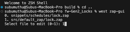

#2. When west zap-gui is run, it presents two options. Do we have documentation for this?
