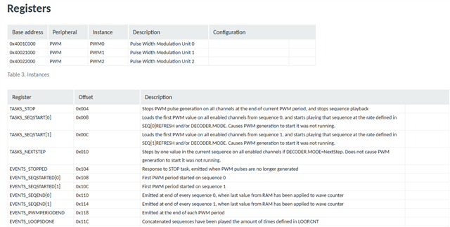

The output of nrfx_pwm_task_address_get is 0x40022008 as I'd expect from the PWM peripheral registers table for PWM2
However, nrfx_pwm_simple_playback returns 0x40018008, which doesn't seem to match up to any of the addresses in the PWM table. Instead, I found that it seems to be in the address space of the SWI peripheral.

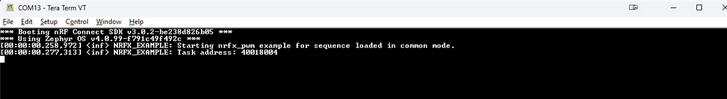

  • Hi Hung,
    I couldn't quite get your project to build, but I modified the sample directly and added the log statement for the address.
    Here's what I get for the nRF52832 devkit:
    And here's the output from a nRF5340 devkit:
    Looks like the base address is correct for the 5340 (0x50023000) but I don't recognise the offset from the table. This is all on NCS v2.6.1
    Here's the return address on the 52832 DK using NCS 2.7.0:
    And using NCS 3.0.2:
    I unfortunately do not have a 52840 DK to compare results with you.
  • I tested Hung's project to run on nRF52832 with SDKv3.0.2 and got the below output, seems OK.
  • That's the same return I'm getting, but shouldn't the return address be 0x40022008 based on the PWM registers table?
    The 0x40018000 is the base address for the SWI peripheral instead. I'm trying to understand that discrepancy.
