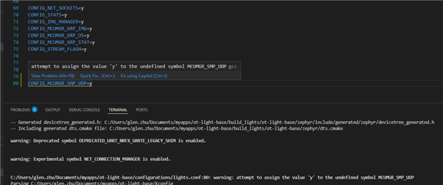

I'm thinking maybe enabling CONFIG_MCUMGR_SMP_UDP would change the situation here. I've read documentations on CONFIG_MCUMGR_SMP_UDP, but when I attempt to configure it in prj.conf, it is not recognized as a symbol, I failed to find more information as to why it isn't recognized here.
I would appreciate any help going forward. I'm not finding any recent discussions on this method of FOTA; the ones that I can find are all from long ago and many sample programs and pages have deprecated.

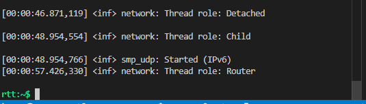

    I have always been looking at the debug logs from the RTT. In the example below, I'm sending the image list to port 8341 (instead of the correct MCUMGR_TRANSPORT_UDP_PORT, this is the port where I have a handler that prints the bytes received. I have trouble logging the outputs of another port) :
    I believe the above is an indication of the pi and nRF54L15 are connected, and I'm able to catch the bytes sent to me this way, but just at the wrong port.

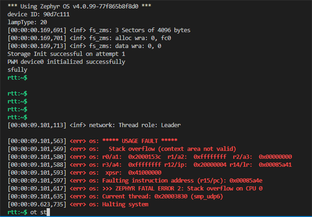

    Here is a relevant chunk of code and log from my nRF54l15 development board. I call smp_udp_open from the state changed callback function; when my device attaches to the network as a child, it will call smp_udp_open.
    However, I am unsure of what exactly is producing the error. If the function did not return successfully, then according to my code it should log "Error initializing SMP UDP transport with smp_udp_open()"? However, this log is not present, this may be an indication that smp_udp_open probably returned successfully. We are however, seeing another error that was not manually written by me, I am suspecting that one of the configurations in prj.conf lead to this. The full list of my configurations are attached below for your reference. Thanks!

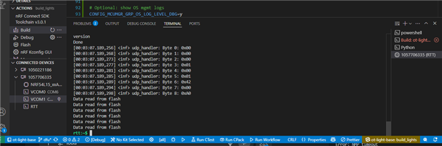

    Just another update, I tried sending more packets over to my device. All of them have timed out. But I also verified that connection to the device should okay, as shown below:
    _@raspi5-2:~ $ mcumgr --conntype udp --connstring [fdb4:4ee4:da2a:6d93:0:ff:fe00:3000]
    :1337 echo hello
    Error: NMP timeout
    _@raspi5-2:~ $ mcumgr --conntype udp --connstring [fdb4:4ee4:da2a:6d93:0:ff:fe00:3000]:1337 image list
    Error: NMP timeout
    _@raspi5-2:~ $ nc -6 -u -v fdb4:4ee4:da2a:6d93:0:ff:fe00:3000 1337
    Connection to fdb4:4ee4:da2a:6d93:0:ff:fe00:3000 1337 port [udp/*] succeeded!
    The dump here also suggests that the packets were indeed delivered, but there has been no response:
    I read in another thread that we might need to enable certain configurations to ensure the handlers are enabled, such that my device will respond. I believe I have all the necessary configurations, here is my prj.conf file again, for reference:
