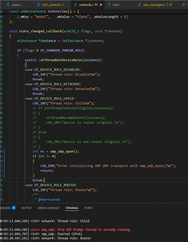

    Here is a relevant chunk of code and log from my nRF54l15 development board. I call smp_udp_open from the state changed callback function; when my device attaches to the network as a child, it will call smp_udp_open.
    However, I am unsure of what exactly is producing the error. If the function did not return successfully, then according to my code it should log "Error initializing SMP UDP transport with smp_udp_open()"? However, this log is not present, this may be an indication that smp_udp_open probably returned successfully. We are however, seeing another error that was not manually written by me, I am suspecting that one of the configurations in prj.conf lead to this. The full list of my configurations are attached below for your reference. Thanks!

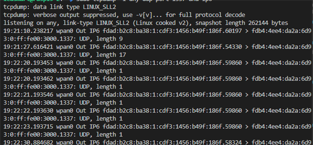

    Just another update, I tried sending more packets over to my device. All of them have timed out. But I also verified that connection to the device should okay, as shown below:
    _@raspi5-2:~ $ mcumgr --conntype udp --connstring [fdb4:4ee4:da2a:6d93:0:ff:fe00:3000]
    :1337 echo hello
    Error: NMP timeout
    _@raspi5-2:~ $ mcumgr --conntype udp --connstring [fdb4:4ee4:da2a:6d93:0:ff:fe00:3000]:1337 image list
    Error: NMP timeout
    _@raspi5-2:~ $ nc -6 -u -v fdb4:4ee4:da2a:6d93:0:ff:fe00:3000 1337
    Connection to fdb4:4ee4:da2a:6d93:0:ff:fe00:3000 1337 port [udp/*] succeeded!
    The dump here also suggests that the packets were indeed delivered, but there has been no response:
