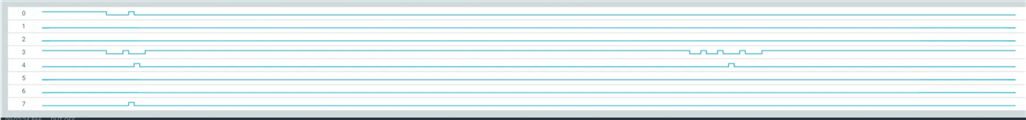

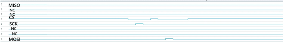

I've tried to look up what's happen on the analyser :
When it fails :
When it succeeds :

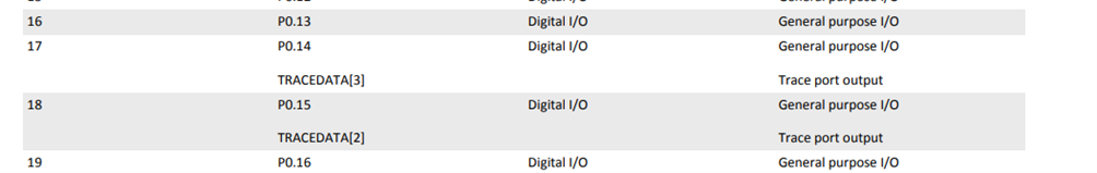

I don't see anythiong on the datasheet that would explain this, except maybe the TRACEDATA but I'm using RTT and logged NRF_CLOCK->TRACECONFIG == 0 so I guess this should'nt be a problem ?

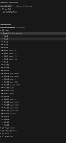

    Your configs and dts seem correct. Usually this issue could occur because the pins are being initialized or used elsewhere. Could you verify that the pins P0.16, P0.13, or P0.14 are not being used by any other peripherals or by anything else on the custom board?

    I added
    /* Disable the four user buttons that ship with the nRF52-DK */
    &button0 {
        status = "disabled";
    &button1 {
    &button2 {
    &button3 {
    To my overlay file but the problems is still here. Also I don't see any pin variation around the Chip select on the PINs I'd like to use (13,14 and 16) when I do the working version with default pins (31,30 29).

  • Hi Alois,
    Apologies for the delay due to the summer vacations here in Norway and many are away on vacation.
    Could you check the dts file in the path: build/zephyr/zephyr.dts
    to see if  the button nodes are actually being disabled.
    Please take a look at this: https://docs.nordicsemi.com/bundle/ug_nrf52832_dk/page/UG/dk/hw_io_expander_buttons_leds.html I guess you would need to make some solder bridge changes accordingly to actually use these GPIOs.
    -Priyanka
