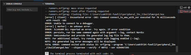

hai thank you for your reply , i just tried for new sdk in vs , in case of segger it can easily be programmed but in case of vs , i can't flash the device
one more doubt , i am using v2.9 button LED ble peripheral lbs will it work in nrf52810 , because even i program through segger J Flash (v8) the devie is not showing in nrf connect in my mobile

Bluetooth: Peripheral LBS should work on nRF52810, yes.
What board are you using, and how have you connected the board to the PC?
Please also make sure that you have the latest J-Link Software and Documentation Pack from Segger and the latest nRF Command Line Tools. Despite the warnings, nRF Command Line Tools is still needed, and I can tell that the project you are building is using it since it uses the command line tool of nrfjprog
