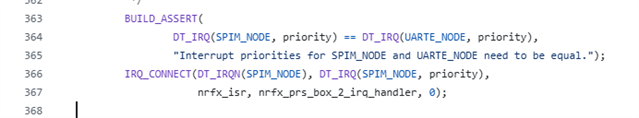

Then, in the code, it seems to install a shared interrupt handler:
/* Install a shared interrupt handler for peripherals used via
* nrfx drivers. It will dispatch the interrupt handling to the
* driver for the currently initialized peripheral.
BUILD_ASSERT(
DT_IRQ(SPIM_NODE, priority) == DT_IRQ(UARTE_NODE, priority),
"Interrupt priorities for SPIM_NODE and UARTE_NODE need to be equal.");
IRQ_CONNECT(DT_IRQN(SPIM_NODE), DT_IRQ(SPIM_NODE, priority),
nrfx_isr, nrfx_prs_box_2_irq_handler, 0);
Is this the correct way to do things?

    Now, in the sample that you linked, it uses IRQ_CONNECT to connect the interrupt to the nrfx handler. This is necessary for the nrfx driver to function correctly:
    Some peripherals (e.g., SPIM2, UARTE2) share the same interrupt line. Zephyr can't manage this dynamically, so nrfx_prs lets multiple NRFX drivers safely share an IRQ.
